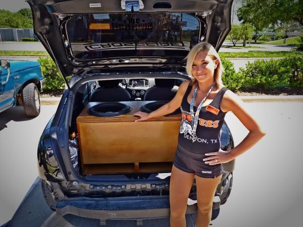

Bronze Member Username: MlstrassIllinois Post Number: 20 Registered: Jun-07 | hatchback is feasible, I "assumed" a trunk car which isn't so easy to get loud. Really depends upon where your car peaks at as a Q off 1200 isn't an SPL set up, but mid 40's are possible. How do you like the sub as I run a 15" Q in the wife's car and find it to be a bit bottom heavy at times. HU doesn't have much for EQ to tame it down |

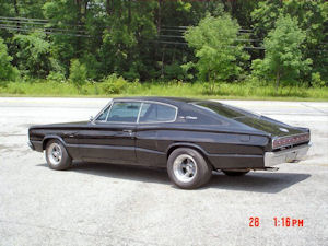

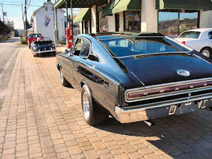

Platinum Member Username: GlasswolfLexington, SC USA Post Number: 13461 Registered: Dec-03 | My car is set strictly for SQ actually. I'm not an SPL guy. I'm getting older and I'm much happier with a clean, detailed system. I'm running 8" midbass drivers, so the 18" rolls up to those just fine. I'm also running digital time alignment and EQing on 31 band 1/3 octaves, so I can smooth everything out that way. Pioneer stage-4 DEX-P99RS head Orion 2250SX @ 4 ohm stereo for fronts DynAudio System 360 3-way front stage in fiberglassed kick panels Orion 2250SX bridged @ 4 ohms for sub Fi Q18 sealed http://www.glasswolf.net/cars/charger/index.html that's the car. |

Bronze Member Username: MlstrassIllinois Post Number: 22 Registered: Jun-07 | Car looks good and nice equipment. Never got a chance to hear Dyns. I run an active front stage in my set up that sounds very nice, but is far from an all out SQ set up. Of course I have a LOUD rear stage for demo's and a wall with 4 15's, but I can actually tame them down very nicely to blend with the fronts. And I'm now betting on low 40's at best since the Q is sealed But I'm sure it's more then enough to give you some thump when you're in the mood... |
