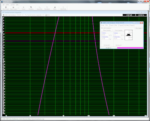

Platinum Member Username: GlasswolfLexington, SC USA Post Number: 13399 Registered: Dec-03 | try this? http://www.glasswolf.net/misc/sixthorder.png ![]() |
