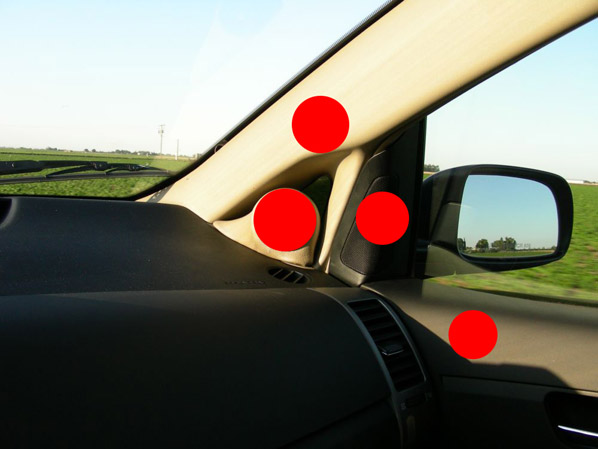

Gold Member Username: IlluminatorUSA Post Number: 5095 Registered: Apr-05 | That's good equipment so far, especially for what you're wanting. No worries about going with the Kenwood. You're supposed to get what you want, not what I want haha. I'm not a salesman, that's for sure. So there is a way to mount speakers in the front doors without getting kickpods? I think you'll be impressed with that set of Diamond component speakers. My suggestion is to mount the tweeters near the A-pillar where any of the red dots are: The problem with mounting the tweeters lower is that higher frequencies are deflected much easier than lower ones, thus by putting your leg in front of the tweeter etc. you are going to muffle the treble. That's one of the reasons why mounting it near the A-pillar is ideal: they won't get blocked by anything and can make it right to your ears. They do, of course, also bring the soundstage up and make it more realistc. I would really recommend a sealed with the Kicker subs, but yeah, if you're willing to build two different types of boxes, then that would be ideal. See which one sounds best. You'll have to keep me updated as I'm curious myself as to which one you'll end up liking more. Yeah, this stuff can be addicting, I'll definitely give you that |
Bronze Member Username: SchinnerPost Number: 83 Registered: May-07 | is it good to have the tweeter that far from the mid?? i thought it was best to keep them right next to each other for timing? i guess if i can keep them roughly the same distance away from my head as the mid, it should work good? i guess it'll prolly be easiest if i just hook them up and move them all around to find the best spot/angle...maybe it will work out that i can put them where the old 3.5s are, they are in dash corners, where the vent comes out in the pic you posted...then maybe angle them from there... im really excited to hear this setup, my last one was a ford explorer with 5x7 front and back pioneer premiers...jvc headunit...2 10" cvrs...and a zx750.1 the speakers were powered off the headunit and had zero midbass what so ever. when it comes to mounting the mids i have to start from scratch...i was planning to maybe cut the door panel in half below the arm rest stuff and making a new lower half out of mdf with a baffle right on that (that way when i get a new car i can re-blend the old half back into the door)....kicks are an option i suppose, but like i said i really want to return the stereo to stock when i get a new car...few years down the road...college... i'll have to snap some pics of what im working with...i came up with a really neat idea for the enclosure for my 1 cvr...im excited to start constructing and installing all this stuff....sucks that schools not over for a few more weeks and i dont have any access to tools or anything to get going on the project until i go back home for the summer. |
Gold Member Username: IlluminatorUSA Post Number: 5096 Registered: Apr-05 | Yeah, it's fine to have tweeters mounted there. You'll notice in many newer OEM stereo systems with tweeters, that is where they are typically mounted. In my previous car, I had the tweeters mounted with the midbass drivers and it sounded all right, but then I detached them and moved them to the A pillars and the difference was remarkable, really. I hope it's the same for you. And yeah, it would probably work out quite well to have them where the 3.5" speakers were. Again, as you said, if you just try out different angles then you'll find a location that works best for your musical tastes. And you certainly should be looking forward to that setup! Perhaps one of my biggest thrills in sound quality is just adding an amplifier to the front speakers. It really does make a difference. It definitely enhances the stereo separation as well as gives your speakers much more midbass punch. If you have the know-how to build the speaker panels for the doors, then go for it. You will definitely have to post some pics of how it turns out once you finish. Yeah, this kind of thing can take hours, days even, and it's good to do it when you have the right tools instead of doing a ghetto job or something haha. |
