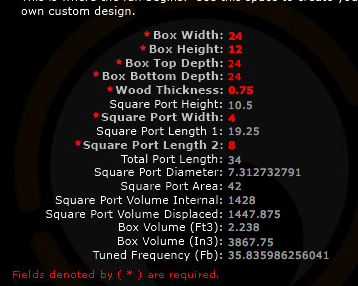

New member Username: TelticPost Number: 1 Registered: Apr-10 | I have four 8" audiobahn AW831T subwoofers. sealed or ported? I really want to build a ported box, I've read countless forums about building... Tried to use WinISD, building a ported box is complex! Anyone want to help me build a box? This is the space I have to work with. (38L x 16 h x unlimited amount deep) slot or ported? |

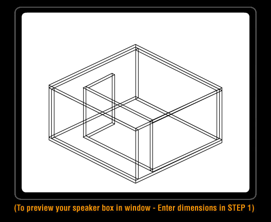

Gold Member Username: Kyle_lowePost Number: 1034 Registered: Apr-06 | the audiobahn website does not have a recommended enclosure volume so i will just go ahead and take a guess at maybe .5^3 ported each i went ahead and did one really quick using re audio software and came up with something like this. subs firing up here are the specific dimensions that should leave you room for sub displacement |
Gold Member Username: Kyle_lowePost Number: 1035 Registered: Apr-06 | oh, here is the link to the re box calculator if you want to play around with it yourself http://reaudio.com/speaker_box/LPort_Box_Calc.html |

New member Username: TelticPost Number: 3 Registered: Apr-10 | Okay so correct me if I'm wrong (I'm most likely wrong..) but I used that program and did this. http://www.audiobahn.com/Audiobahn06/images/tech/2007/boxParams/Natural_box_specs.pdf this site says I need .75 cu ft per sub... i have 4 subs so I need 3.0 cu ft. I design a box with that program so I have 3.0 cu ft like so. almost seems too easy, I have to be doing something wrong... any comments/criticism/tips?
