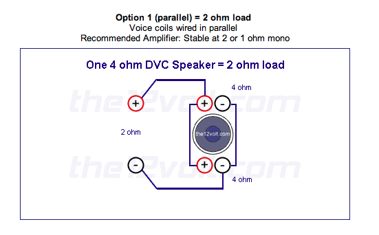

didnt you say that you had two sx's that were dvc 4ohm?
regardless, from what you are saying, a svc 4ohm sub can not be wired to a 2 ohm load, only 4 ohm.
but im pretty sure you have the dvc 4ohm because i do not think the sx's came in svc.
it would look like this
also, here is a link to a website where you can put in all of the info yourself it it will show you the diagram
http://www.the12volt.com/caraudio/woofer_configurations.asp?Q=1&I=42#results

you would have to get another 4 ohm sub and wire them in parallel to get a 2 ohm load.
