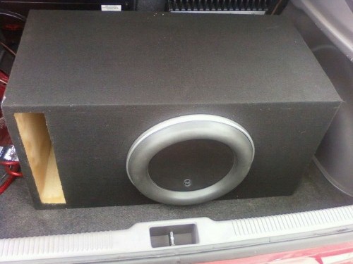

What a 2.0 ft^3 12 w7 box tuned to 32 Hz looks like.
(Dustin constructed)

That looks exactly what I want to do. Any chance u rememeer ylthe dimensions? Otherwise I can easily calcate it just curious
The box I originally made I believe is just too big. I plan on makin g one like that this weekend.
Put the sub in it yet?

that pic is pretty much what I was describing, right down to the doubled panel for the sub to support the weight.

Nice picture

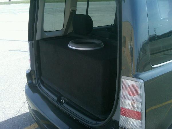

Here is my first box. Im gonna be making the one in the picture shawn and glasswolf talked about and do the long port with the corners rounded, this weekend or next. haha Thanks for all your help everyone and ill post pictures when i'm done and what it sounds like
One last thing, would 4" port width be good like you said? or should i go even bigger?

4" was for a round port. If you're doing a slotted port, then a 3" opening is fine. The W7 moves a lot of air. If the port opening is too small, this can cause port noise when using round ports.

If your going to be using a slot port for the 12W7, if 14.25 is the height of the port (which would be the same as you had before) I would have the port 2.25" wide x 14.25" tall. This would give you around 16 sq. inches of port per cubic foot (if your doing 2 cubes @ 32). You could make it 2" and be fine as well too.

The only thing I wish I had done different was had the port painted but it's alright.
