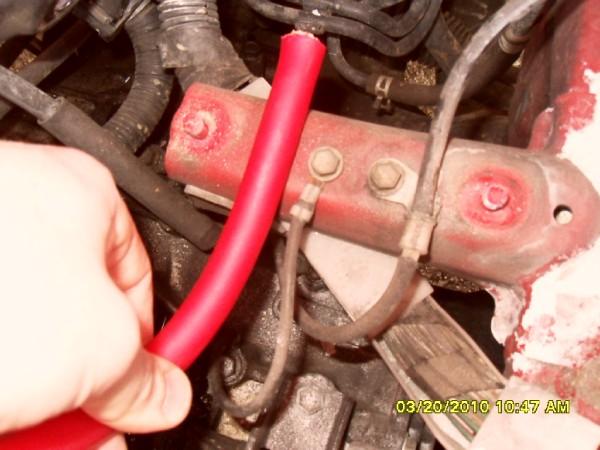

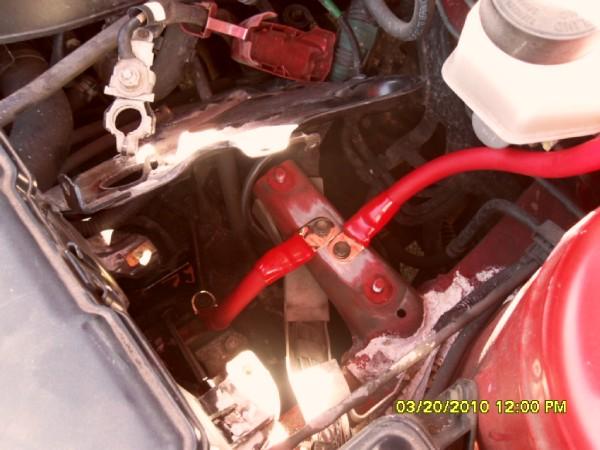

I took out my battery and found the 2 stock negatives right below it. I sanded down the entire area, then connected the new wires in place of the old ones. Then my alt's positive is in the front so it was a straight shot across to the battery. Overall it wasn't too difficult. I went ahead and regrounded my trunk ground while I was at it. I was a semi-noob when I first put all my wires in a few years back. I had it bolted to a bolt randomly in the trunk, which looked pathetic, so I connected it to a bolt under the car directly to the frame. Overall I feel my system is a lot more healthier now. I did have to push it though and find my limits :-) Under very loud volumes my volts did drop lower than I would like. That of course is due to a stock alt at idle. My next 3 goals are going to be to get a second battery in the trunk, upgrade to a HO alt and get my 300/4 fixed finally. I'm cutrrently using an RF 4 channel amp.

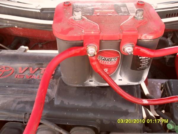

I used ring terminals for the battery as well as the bolts on the frame. My battery is dual terminals so instead of getting new top posts I just ran the new wires to the side posts, as well as the wire running to my amps, then left the stock wires on the top posts.

I picked up the stock screws that screw into the side post terminals and used ring terminals on the ends of the wires. Then just put the screw through the opening and tightened it down. You're looking at getting new posts for a top post battery. My battery has both top and side posts. I left the top stock and ran my new wires to the side.

Holy cow I posted a picture and it worked! Anywhoo, as shown above I ran the new leads to the side posts and put the stock back on top where they were originally.

Look at the difference in size.

man look at how puny that stock wiring looks to the 0g - kinda looks like 8g ...
Username: Mendonmafia
Post Number: 1997
looks like it could even be 10 to me. im actually surprised it didnt burn up lol
