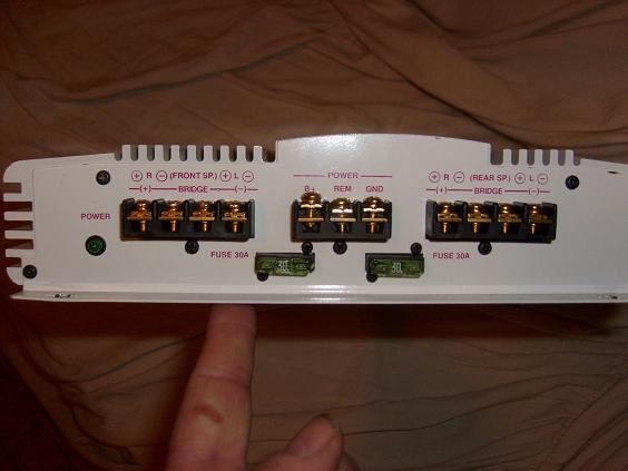

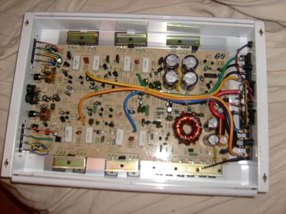

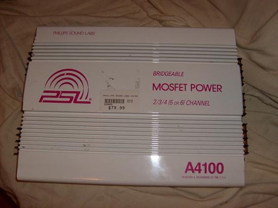

Say, Do you know anything about this amp?
Phillips sound labs A4100
Designed and engineered in the USA.
2/3/4 (5 or 6) channel
Thanks, Marc.

Dio, not familiar with that specific amp, but it looks nice. From the looks of that PCB, I'd guess a production era of say.. mid 90s maybe? It looks older, but a pretty clean amp. 100W x 4?
