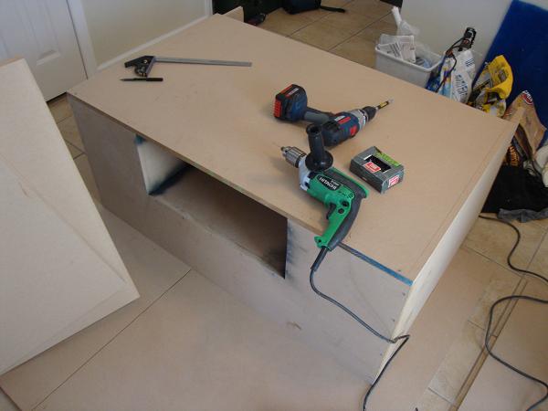

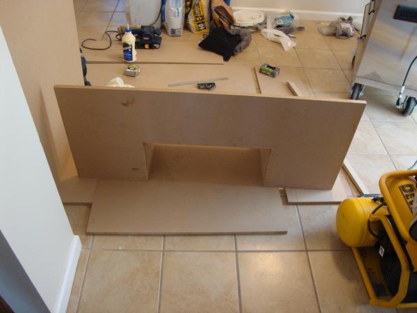

I'm going to start a new build log for this, the topic of the UPS thread didn't seem fitting.

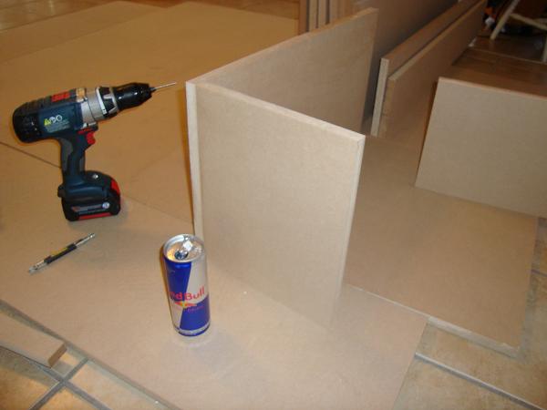

Wood cut.
Build power in a can- no build is complete without energy drinks imo.
Port

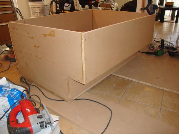

Sides and bottom in place
Battery powered circular saw is so awesome for small cuts like this one.
As it stands, it just needs the top layer glued and screwed in place, and the holes cut out. I need to pick up a new router jig. I won't have the copper ready for tomorrow, but I'll have the box in at least.
And yes I'm doing my build in a random house lol.

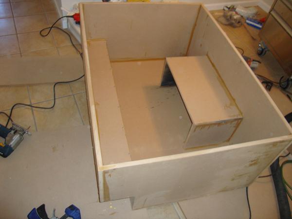

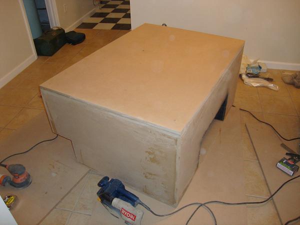

Mark- I'm going with 15ft^3 net, tuned to 36hz. The port is 10hx22d, so 220sq inches. I figure once I get another daily box made it'll be really easy to chop this port shorter to do a bit of spl testing.

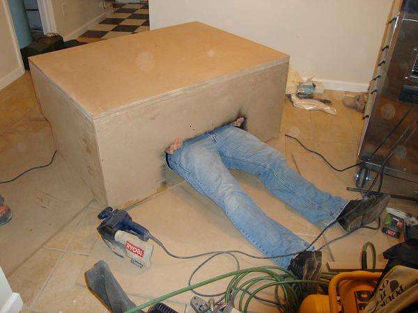

funny pic of u in that port ...

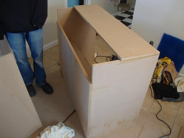

cant tell from the pix but is that 3\4" mdf ur using ? ....

Yes sir, 3/4 mdf, double baffle. I will use Birch or similar for the next box probably. It really just depends on how much I like this one.
I always round over the port and stuff, but I'm more interested in actually testing what little differences will make with this.

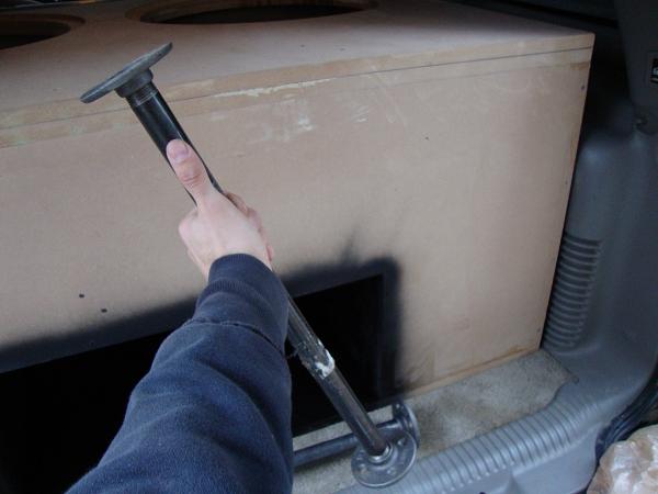

for that size & such powerful subs i wud use nothing less than 1" , some internal bracing or maybe some threaded rod since i expect high 50s possibly 60 from that set ....

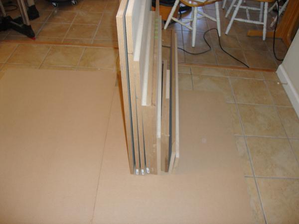

Thanks Charles, I try to post lots of pics, but honestly because I let Lowes do a few cuts it didn't turn out as perfect as I would have liked. The damn port's a bit off, first box I've ever had something dumb like that happen. Fk retards that can't cut good with a damn panel saw. Yes there will be vids.

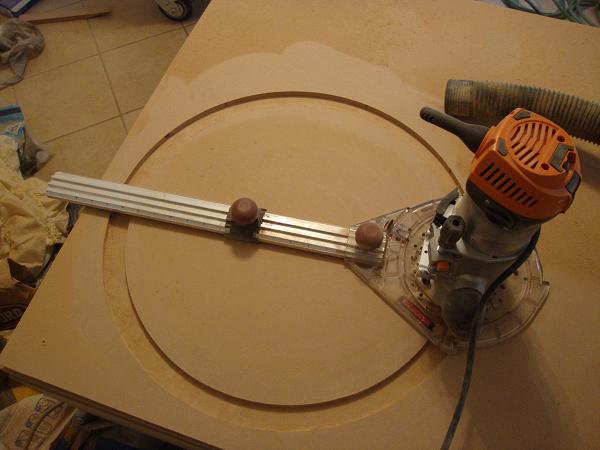

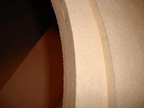

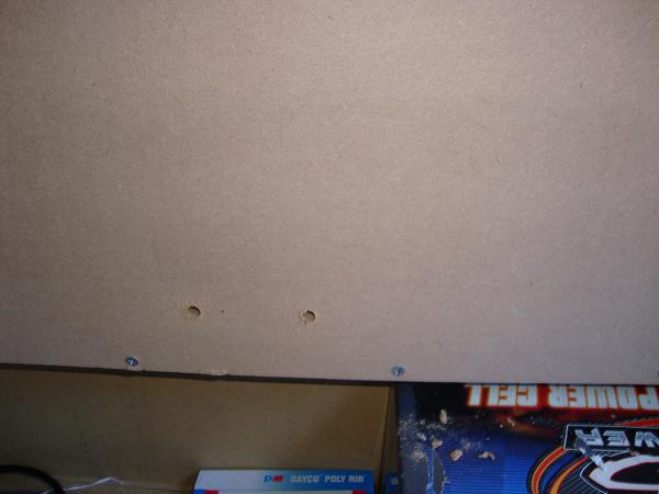

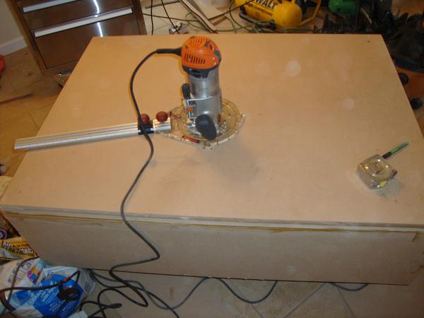

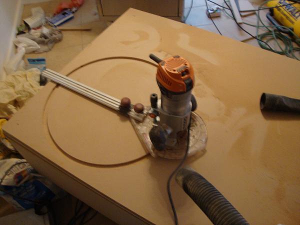

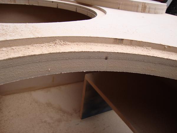

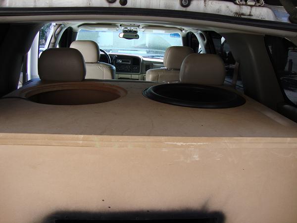

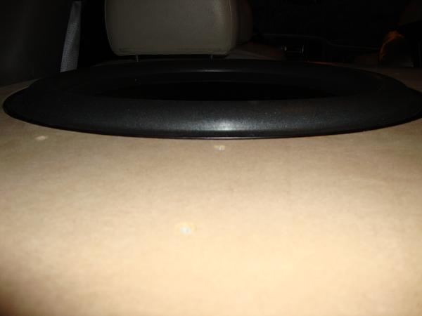

Cutting the sub holes. I love this new Rigid plunge router. I don't have the plunge base on here, but it works so good. It's amazing- It has the same power ratings as the Hitachi and Porter Cable I used before, but cuts sooo much quicker without bogging down. Also the 1/2" Fuego bits from home depot work a lot nicer than the up spiral bits I've been using.
Two quick passes makes a nice ~1/4 inch deep x 1 inch wide recessed area.
Upload\
One more time

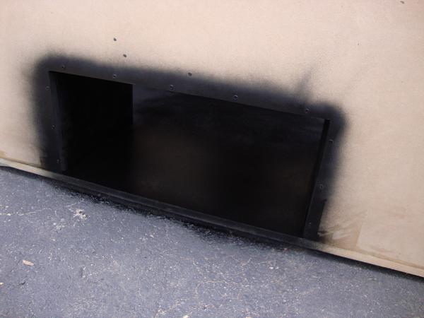

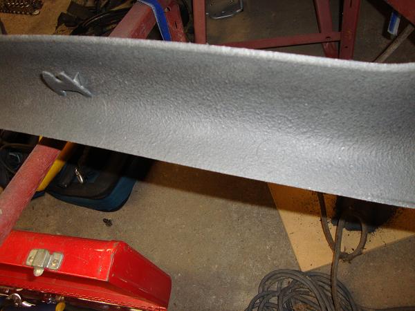

Painted the port black. Primer + 2 coats of this Rustoleum lacquer stuff. Another coat or 2 should make things very smooth, but damn it's black.
I like where this box sits. It's higher than I wanted to make it, but it leaves somewhere around 8-10 inches from the back gate.

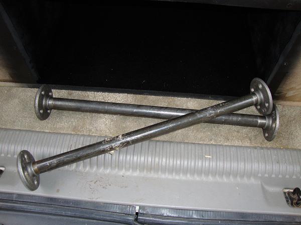

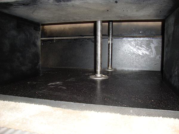

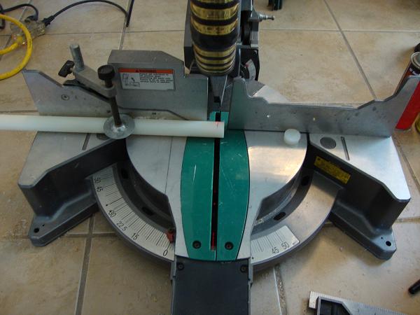

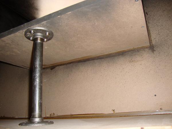

Bracing. I figured 3/4" pipe should be better than threaded rod. And much easier to install. I plan on putting some resin or something in it, I can't decide what.
Test fitting a sub, I'm happy with how it sits.

I let one guy do my cuts- I marked where to cut with a square and pen- marked the scrap side so he could cut right next to the pen mark. PERFECT cuts. The dude understood how to cut on a line.
The guy who cut this time didn't even cut on the right fckin side of the line, and didn't understand that a saw blade takes up like 1/8" or something. Asshat really pissed me off.

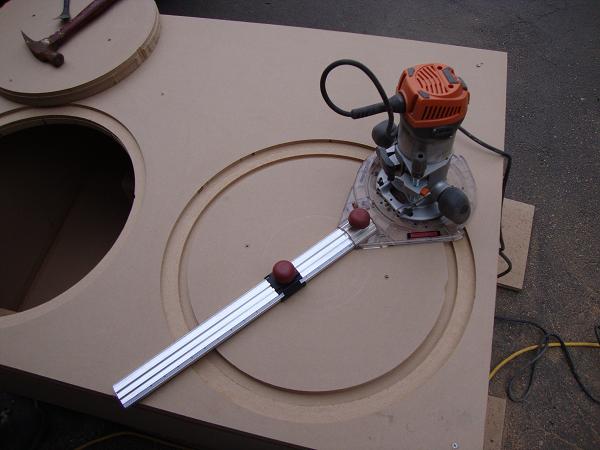

Troy,, what circle jig setup are you using?

how much dust does that router make & which jig are u using ? ...a while ago i bought a craftsman circle jig but i found it to be bulky & poorly made , it had a stupid nail as its point so i sent it back & never even tried it ...i still use the ol jigsaw method

Mark I got the circle jig from Lowes for like 15-20 bucks- it's the only one they stock now. I have 2 of them and I'm pretty happy with how they work. One of them has shown signs of wear- basically since the whole thing is plastic some parts are prone to crack. It's quick to adjust, and cuts up to 40 inch diameter holes. It works good for the price and availability imo.

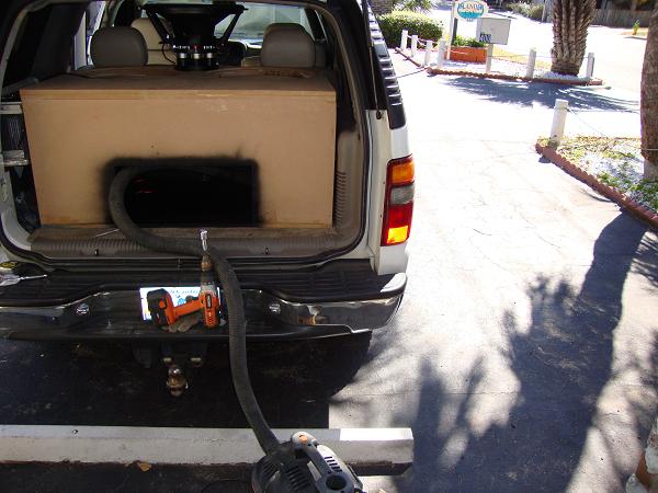

It snowed here in Myrtle Beach SC, which means I'm not driving to go do work. I left the copper bars and stuff about 1/2 an hour drive away, and people don't know how to drive. Since we're celebrating Valentines day today- I wont be working late. I doubt I'll get anything done today other than some wiring.

I was considering something like that rovin, but the words were taken out of my mouth- I plan on putting pvc on some angles to see how it effects things. I wanted to build a box quick and have it ready to test, so a lot of extras were left to come back to.and see where I gain. Then I'll build another daily box, then a good spl box, then I'll go back to the single sub and see what sort of #s I can get with that. I'm not the sort of person that enjoys testing lots of different equipment. I ran the same subs since '06, and finally decided it was time to change. I plan on keeping these subs for a long time as long as the coil config works out- just building lots of boxes.
This jig also uses a nail to hold a plastic piece in place to center the jig up. It would be much better if they worked on that aspect of it, but overall the jig cuts holes the size I need. I don't think it will do 10" cutouts, but I used it for a 12 and it just fit. I don't think I'll ever do another 10 if I can help it anyway lol.

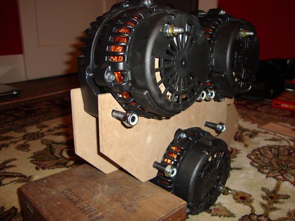

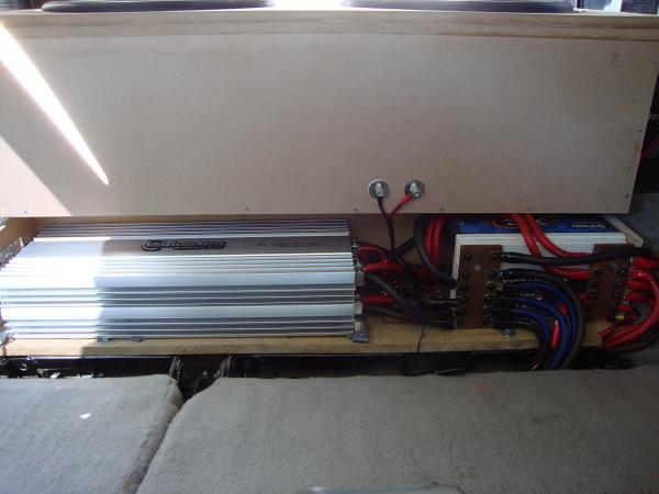

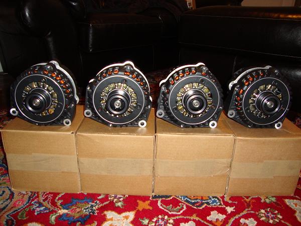

Mark electrical is supposed to be 4 Iraggi 220s (like 180 at idle) and as many 3100s as I can fit. Also 8 runs of 1/0. 4 batts right now, but in a few months maybe I'll have cash to weld a rack under the car like I want to. That'll give me room for another 4 or 5.
For now It'll be roughtly 720 idling amps/900 peak, and 4 batts.

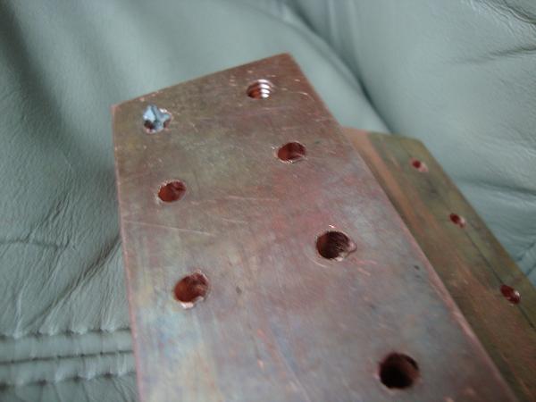

I was taping the final bit of copper today and had another tap break. I had a shop remove the fragment, but god knows when I'll have more time to get them finished :-(

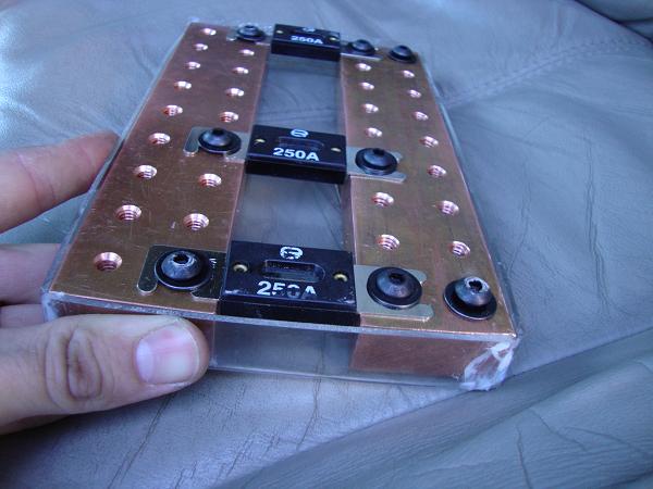

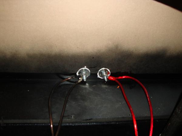

I got the terminal bolts put in today, although I started wiring for 1 ohm and realized I don't have my alternators yet :-( So I'll be rewiring for 4 ohms for now.
I also got the "fuse holder" setup almost done. It's at least enough for me to hook fuses/wiring until I make the top cover. I'll get the amp in tomorrow and maybe the bracing. If all goes well I'll be able to at least listen to it at 4 ohms
The tap that broke off
I made a plexi case to hold the bars and give me a nice way to mount them. I plan on making a cover with some spacer to prevent objects from falling on top of the blocks, but this will get it playing.
The white corners are clear silicone to seal things smooth - it wasn't dry when I took the picture. Goes on white, dries clear.
And mounted in place
Drilled the holes
A bit of silicone to seal the washers tight
Username: Domenico
BanginGMCArizona
Post Number: 794
Registered: Apr-09
what wire are you using?
Username: Basebalz13
Moneta, Va Usa
Post Number: 2038
Registered: Aug-07
werrrrrd
Username: Insearchofbass
York, Pennsylvania
Post Number: 13430
looks very flexible
Username: Domenico
BanginGMCArizona
Post Number: 795
Registered: Apr-09
Are the positive wires(red) going into the same casing?
And it looks like one of the negative(black) casing fell off.
But yes it looks very good, defffinetly not 12ga.. 10 or bigger.

I'm using tsunami and Q-Power I believe. I've had it around for years and years. It's all translucent and pretty good stuff. I have some RF I might use in some places, but copper wise it's pretty much identical.
Each wire has its own ring terminal, they're just close together.
Each wire has its own casing, though some may not be on all the way.
The wire size is 8 gauge.

Whats the reason you go with 8ga? Does it fit in the amp nicely?
Username: Tejcurrent
Post Number: 2108
Registered: Apr-07
8 gauge seems to fit in everything perfectly. The push terminals on the subs would definitely fit more than 8g, but not 4. The amp terminals fit 8g well too.
Also outside the box from amp to sub looks 'prettier' with the red/black wires than a normal piece of 12g. That's really the only reason. I got it for free for a while there too.

It's up and running! It's only 4 ohms, but it's great to have bass.
Taking the kids out:
Bracing
Final Vacuum job. Made sure things were nice and clean in there.
Wiring up the sub
You know the commercials with the happy/sad faces visible in different objects? Here's one for you :-)

Yeah, I probably put $250-300 a month in my truck with no problem. So worth it though. I grew up driving vans and large Cadillacs, smaller cars are great for somethings like gas mileage. But if I can't carry as much as I want to the destination it does me no good anyway.
Username: Mendonmafia
Post Number: 1945
your truck is sick btw. and i love how the hatch moves more than the woofers haha.

There's just no way to make that much wire in that small a place look super clean. It's just too cramped an area, with no where to hide anything.
http://www.youtube.com/watch?v=AkGOpNSWJHs
http://www.youtube.com/watch?v=fiLb-KSpFJk
Username: Simple_smith
Lapeer, Michigan United States
Post Number: 284
Registered: Dec-08
i'd say that looks pretty damm clean for how much wire you do have. It could be a helluvalot worse lol
Username: Van_man
Boston South, MA
Post Number: 5195
Man, You always have over the top installs. Good stuff Troy.
Diamond Member
Www.stainles... .ecrater.com
Post Number: 22157
Post Number: 1947
looks like sh1t! lol jp man looks pretty nice but maybe you could put a panel over everything if you dont want to see it.

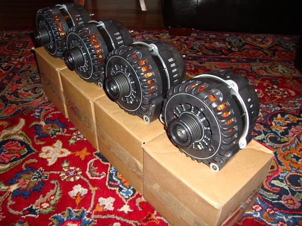

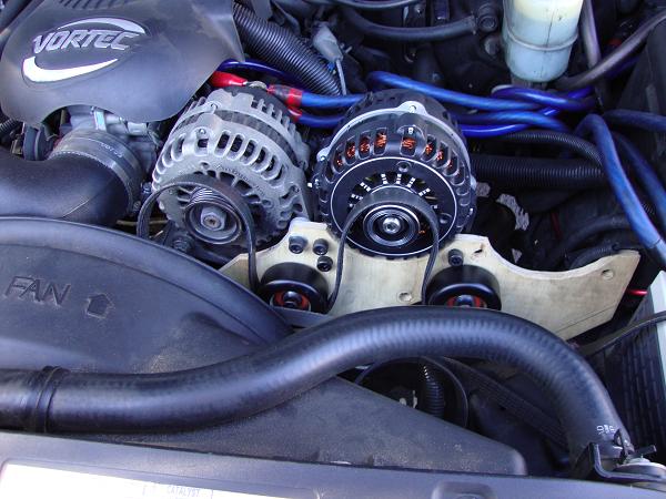

Alternators arrived today :-)
4 220a Iraggi's with Quad bracket. Satin black.
UploadUpload

Username: Snowball123
West Allis, WI
Post Number: 3441
Why did you end up going back to Irragi?
I thought you had a poor experience with your 300 amp one.
Post Number: 2120
Registered: Apr-07
I told him (and many others) about the issues I had with him before. A few months back I noticed he really started picking up in the c/s department. People were leaving nothing but positive feedback, etc etc.
He sent me an email offering to help make things right. Long story short he hooked me up, he's been responding promptly to emails and pms, and the product he sent me this time looks flawless. Only time will tell, I can't wait to test the alts, but I'm 100x happier this time around with the overall experience.

I feel like I'm cutting it close with 8 total runs, I'd like to have at least 10.

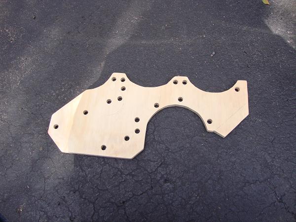

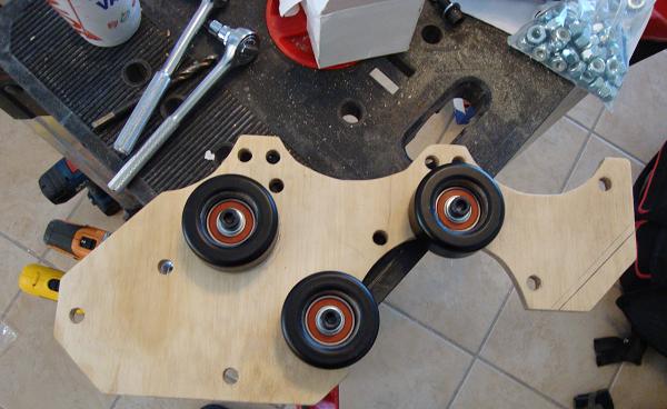

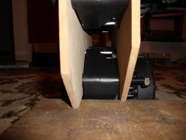

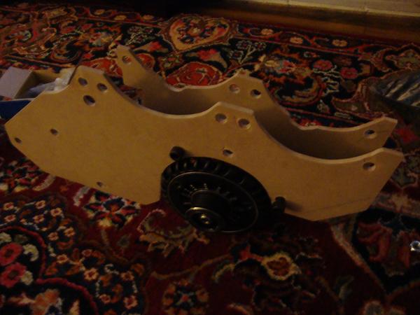

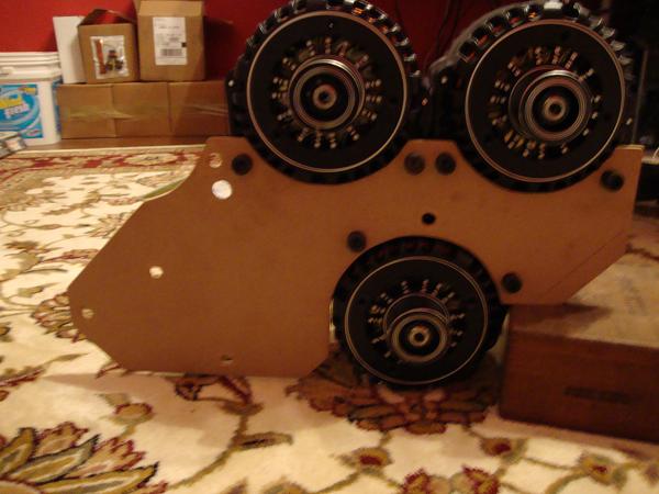

I have an Iraggi quad bracket I just received, but I'm not 100% sure I want to use it. No disrespect to his product, I want to try to make my own. I just want to do it a bit differently than others I've seen, if it works great, if not I have one to fall back on.
Anyone considering making their own bracket that doesn't have a welder or means of cutting 1/2" steel - don't think you're saving money going this way instead of buying one lol.
1/2" wood mockup to have machined. It's pretty obvious how the alts fit. It bolts to the engine block in 4 locations so it should be very solid.

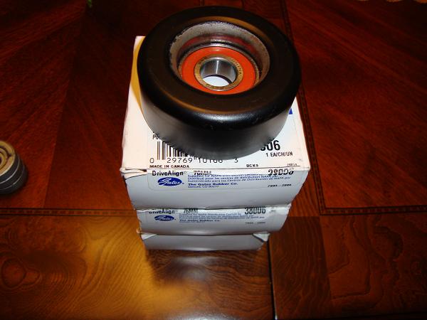

I bought these pulleys some time ago, just factory replacements for my vehicle.
NO ONE had spacers for these pulleys other then the dealership- and at $60 each they weren't worth it. I stopped by a local car crushing place that let me pull them for free. Otherwise having them machined would have been expensive.
Factory spacers with factory pulleys should be solid I figure.
Hopefully I'll get to test this on the truck before long, I want to get this machined out soon. Another benefit to this design is you can run 2, 3, or 4 alts depending on pulley location. Criticism welcome.

I'm going to upload some progress pics in a little bit, but I installed one alternator for testing.
Non-technical info: looking at my dash voltmeter that is not very reliable I had no voltage drop while driving- while the factory would go down to about 13.5.
At idle there was still a volt drop. It was similar to my factory alt, so I don't know what to say there. I need to clamp it to give exact results. Iraggi says around 700 engine rpm the alts should do around 180 at idle so we'll see when I increase my idle speed.
With so much output from the front I just figure the more copper the less resistance, more can't hurt :-)

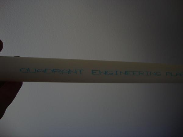

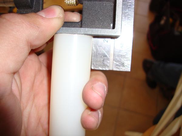

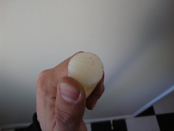

1" nylon rod to make mock-up spacers.
Measuring out.
If you're trying to do something like this the nylon works great. It actually cuts instead of splitting or cracking.
Test fit the bracket- after a bit more trimming I was happy.
Testing one alt.
Username: Yukhui
4 15 AA Havocs, Memphis 4kw!!
Post Number: 1017
badass i got the new pulley yesterday from mechman after strippeing a serpentine belt on the hwy. runs like a champ now

I didn't notice the first pulley set, what was it like?
Man I know too well about breaking down due to belts :-( It always seems to happen when you're in a hurry or don't want to get dirty. I keep a spare belt and a wrench in the car anymore.
I'd like to see things in action with that bracket of yours.
Post Number: 2160
Registered: Apr-07

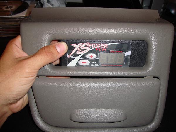

UPS dropped off the final package for a while
Powermaster voltage control module. It will wire up all the alts, and allows the user to adjust the voltage from their drivers seat, from 10-20 volts.
Like a mix between an external regulator, MLA module, and a digital voltmeter.
Going to shoot for Monday to drop the bracket off to get machined as long as I get the final bugs worked out.

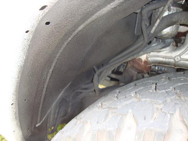

I've been trying to find a center console that will work, but I cant locally. I'm hoping I can in a junk yard within an hour or so of here since I'm not willing to chop my factory stuff so when I sell I can put things back.

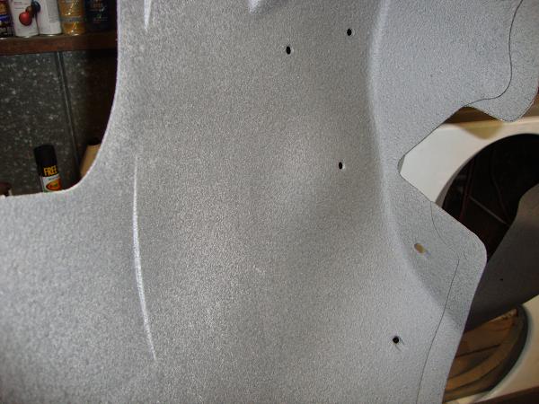

I got tired of the road noise from my front tires and had a spare gallon of Second Skin Spectrum laying around. I removed the front fender well covers and coated them in 4 coats on the inside, 2 on the outside. Then I put 5 coats on the fender itself. I still had enough to put 2 coats on the visible frame going down the side of the vehicle - since I removed my side steps.
Then I realized it looked terrible without the factory covers on my tailgate, so put 2 layers of primer and 2 layers of spectrum on the inside of them. I already have probably a dozen cans of expanding foam in the tailgate so I don't think I can deaden it any more, but at least I shouldn't have any plastic scraping or rattling from those covers.
It rained about an hour later, so I didn't put anything back together- and honestly even with a fan running things didn't dry enough.
It was too crappy to get good pics of everything so I'll upload tomorrow.

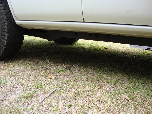

Stripping the tire wells down and cleaning everything.
Primed and coated the panels.
Treated the frame
And wiring the subs down from 4 to 1 ohm :-)
I was really worried this would work. The amp is rated 2 ohms, I'm now running .7- or .35 per board. Scares me a bit, but like 15 minutes straight and everything was ice cold. More pics as work is done.
Post Number: 2182
Registered: Apr-07
That was actually Austin (not on this forum), I did 1/2-3/4 of the wiring, but he did the crappy parts :-)
It's so nice to have a skinny friend, I'm not fat but after 5-10 minutes of wiring in that port you really feel like it's eating your azz lol.
If anyone was wondering the amp is handling things fine so far, it's at .35ohms per board, but after rise I'm going to guess about 1.5 ohms per board. I just adjusted things to be as loud as they were before, keeping the voltage in the 13+ range

I still wasn't happy with the bracket, so I made it 2 1/4 inch plates. I want to re-do the pulley placement, which I'll get pics of this weekend.
Also got some dash parts- I'm doing a double din in-dash that I need a few modifications to fit, and glassing in the VCM.
The bracket
The center console
Pics of the dash when I paint it and chop the parts.
Post Number: 2195
Registered: Apr-07
Just realized I didn't specify- I purchased a new center console insert and dash bezel so I can chop, glass, vinyl, paint, and do whatever to them and just trash them if I'm not happy with the results. Took forever to find the dash though (not pictured) so it's not going anywhere but on the car.
Also you'll notice the front bracket is longer on the right than the back, that's so it can be rolled in a 90 for a bit more sturdiness, though I doubt it'll need it. There's one point I'm going to see about welding a small section of steel tubing to inside between the alts to make a very strong bracket.
It'll look much better in steel, anyone with a 5.3 v8 looking for a dual/triple/quad bracket I might be making several of these, and some dual/triple for fun.

Check ebay for voltage meters. What you're talking about is this: http://cgi.ebay.com/Stinger-Digital-BLUE-Voltage-Meter-car-audio-Amplifier_W0QQi temZ260584880254QQcmdZViewItemQQptZLH_DefaultDomain_0?hash=item3cac11b87e#ht_161 1wt_1165
That does show the voltage, but it is much more than a voltage meter. http://www.stevemeadedesigns.com/board/topic/67679-vcms-ready-to-go/
This Powermaster Voltage Control Module allows you to set your voltage. My truck idles slow, and my idle voltage is 13.8 from the factory. With this module I can increase my voltage whenever I want. Also it will allow me to run multiple alternators without hard wiring harnesses.
