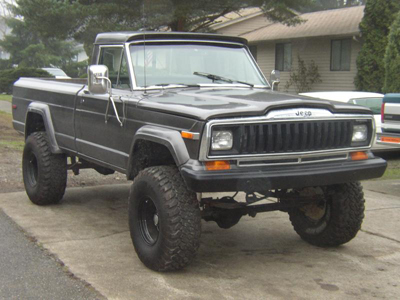

New member Username: TheshonfatherPost Number: 8 Registered: Jun-04 | Wow, if the mounting depths are that close I'll probably go with the 12's. I actually don't get the jeep until next week but I'm sure i can make it work. I'll let you know the final set up I'm going with then. Here's what it looks like: ![]() |
