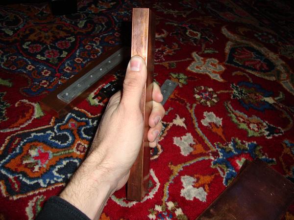

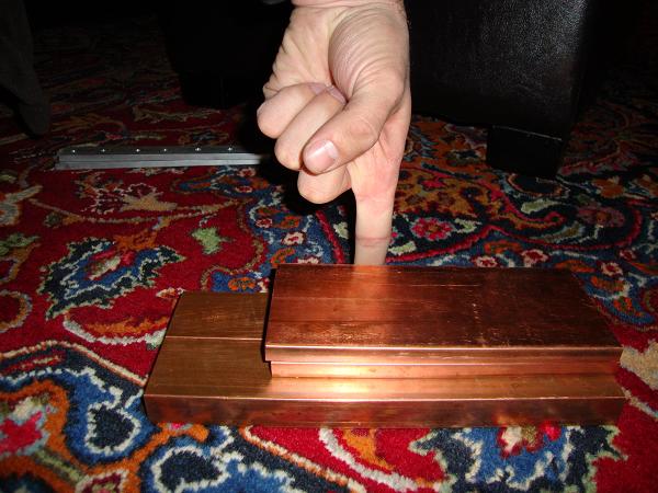

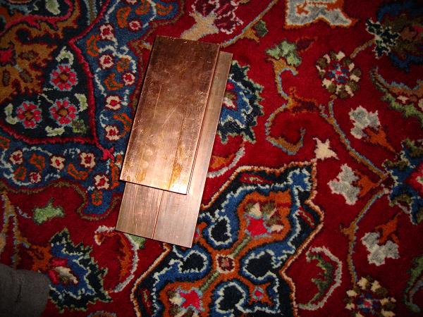

I got the copper in - it should just need the holes drilled and tapped in the right places. I'm all in bunches 'cause I didn't expect them be that much copper :-) I don't have the subs in yet, or a box built so I have a bit of time to pick up the drill press I want to use.

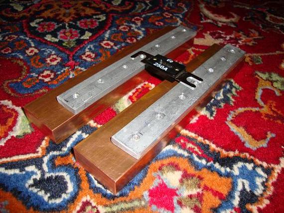

I believe the fuse holders might actually be a bit too big, I'm not sure yet. Anyway, on to pics:

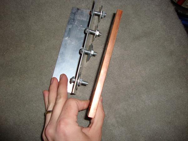

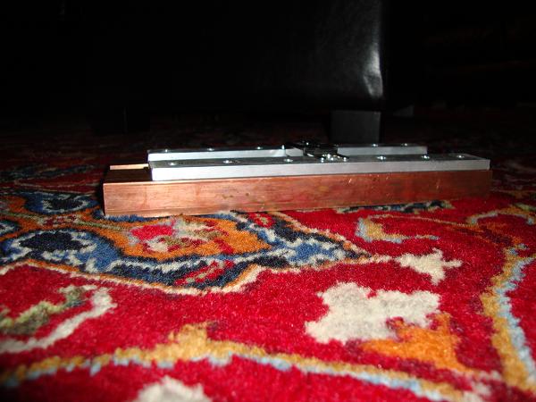

Pic shows the old temporary 1/4" aluminum vs the .75"+ copper. BIG difference.

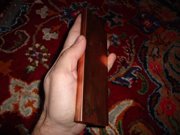

.5" x Distro blocks.

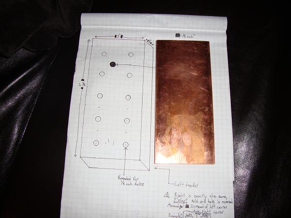

A little diagram I made when having them made, and to let me line up where to drill the holes.

I just thought the copper looked better and would work better than the aluminum I have now. 1"x.25" aluminum vs 1.5"x.75" copper is no comparison, and should leave me room to upgrade down the road.

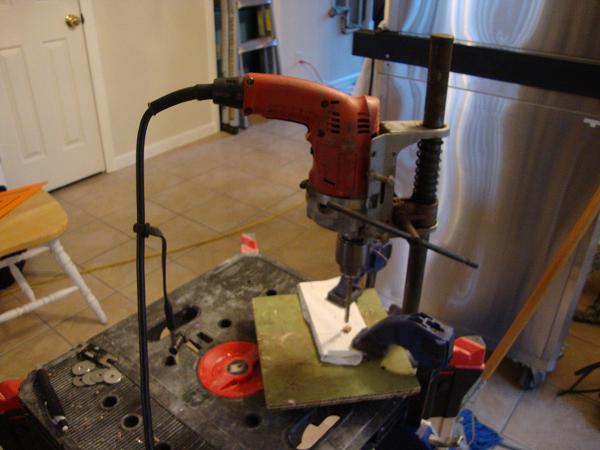

I'll get some pics of my GHETTO drill press tomorrow lol- it's home made for sure.

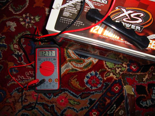

Just got this in tonight:
Just a 3400.
Out of the box:
2 hours on my walmart charger on a 2a trickle later
Just going to let it sit over night and move the 3100 out from under the hood to make room for alternators.

No harborfreight near me. Free is better than $50. If it didn't work i was going to just buy a table top from lowes. It seemed to work though :-)

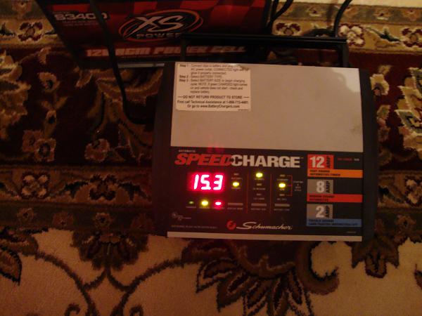

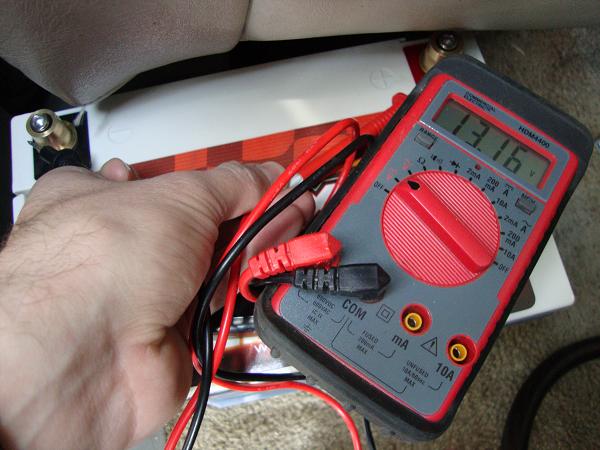

After charging for 12 hours and resting 12 hours:
3100 vs 3400 - a few inches in each direction and what feels like a lot more than 20lbs.
The 3100 under the hood is nice, but it's so big it takes up a lot of room and makes things look really cramped. I prefer the look of this , and my radiator hose thanked me :-)

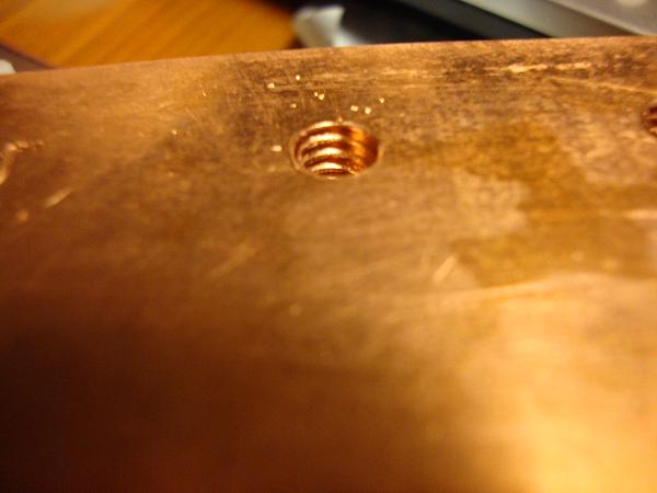

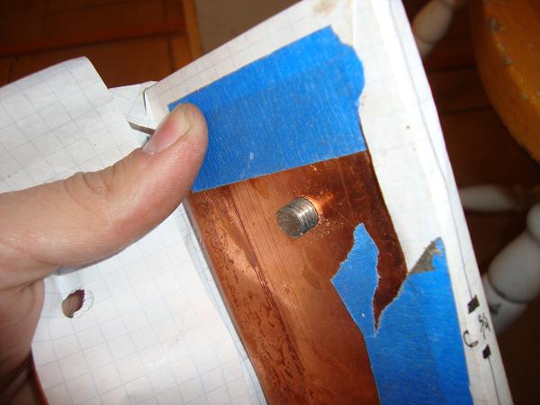

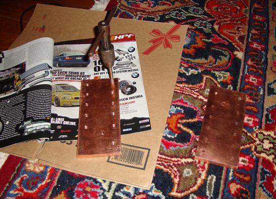

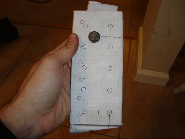

My drill press lol. It took so long to set up I only got 2 holes drilled. I need a new tap anyway, so I'll probably get things finished tomorrow with the battery portion at least.
I used graph paper to plot things out before drilling.

Got a bit more work done- all drilled and threaded. I installed one of the blocks before I had to get busy with other stuff. I think I'm going to have those fuse blocks remade to be a bit smaller.
Pics, and yes I do work in my living room at night lol:
Old temporary vs the new
