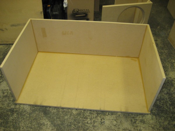

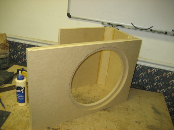

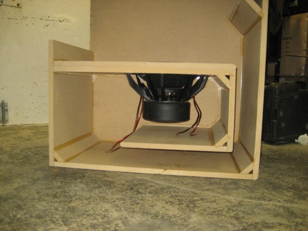

Well its been a long time coming, been without subs on and off since I bought the avalanche a about 6months ago. Got my DDA-series mids and highs in w/ the C4a awhile back, but only built the shell for my 2-DD3515 6th order. Been sticking single 10's and 8's in the shell to demo, did 144.x @ 47hz w/ a single DD2510 in a half-assed 6th order using the shell.
Got my alarm/rs on, so now its time to actually build this thing!

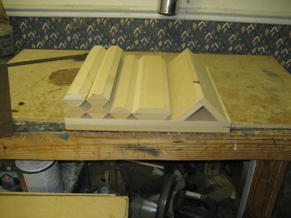

HELL of a lot of wedges:
The shell, allows me to have 1/2 the bed.
Double baffle w/ recessed subs. A few of the wedges going it.
Mocked up in the shell for a pic.

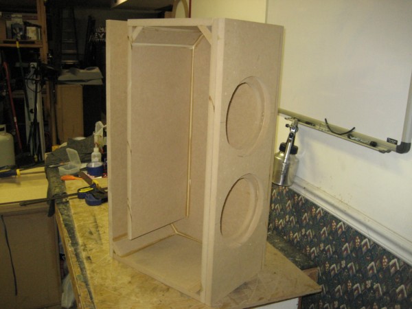

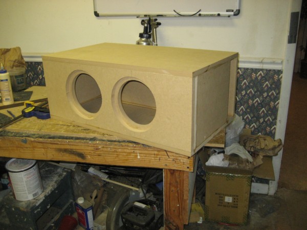

Also built a 2-DD1508 box for a customer today.
1.8cuft, ~37hz, recessed subs and wedges everywhere. Its for an '04 Mustang, going w/ a DDM80 for power.

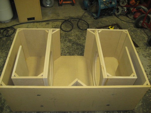

Can you give the outside deminsions of the box? What's the purpose of a 6th order. I don't know what the diff orders are lol

this in a series tuned 6th order. low tuned ported bow firingi nto a high tuned ported chamber. i designed this one to have pretty flat responce from 30 to ~100hz. should a little boost down low ....30-45hz.
outside demins are 49w * 19t * 30d. i plan on building an amp/batt rack in front of the box and wrapping it in black vinyl.

So basically it helps get more out of the subs?

The subs and common chamber will be very visible. The front port is 12"w x 17.5"t.
The 3515's have 6" carbon fiber dustcaps also...the same ones I ran in my '98 silverado awhile back.

This box is designed to (hopefully, lol) sound great and hammer the lows...30-45hz. But still play 50hz-80hz pretty flat.

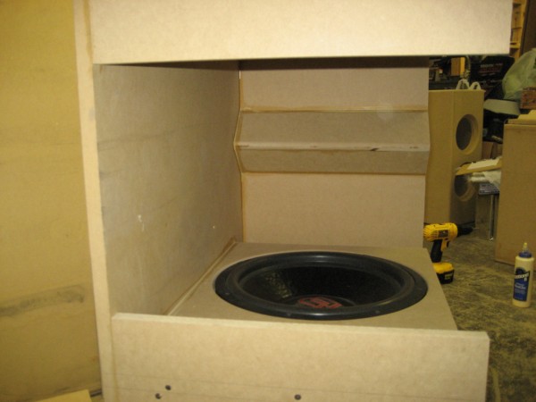

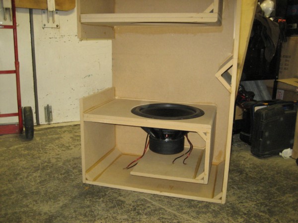

Pretty much put together, starting the amp/batt rack now.
Pretty much what it will look like when you look thru the port.
