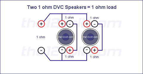

Option 1 (series/parallel) = 1 ohm load
Voice coils wired in series, speakers wired in parallel
Recommended Amplifier: Stable at 1 ohm mono
So this is saying if i buy the 2 Fi SSD's at dual 1 ohm each i can run the subs at 1 ohm as long as my amp is stable down to 1 ohm (which it is)??????

buy the dual 1 ohms. and look at a 1 ohm wiring chart and hook the speakers up like it says.. very simple. and there you have your 1 ohm..

Is this the correct wiring chart for 1 ohm subs and amp?
