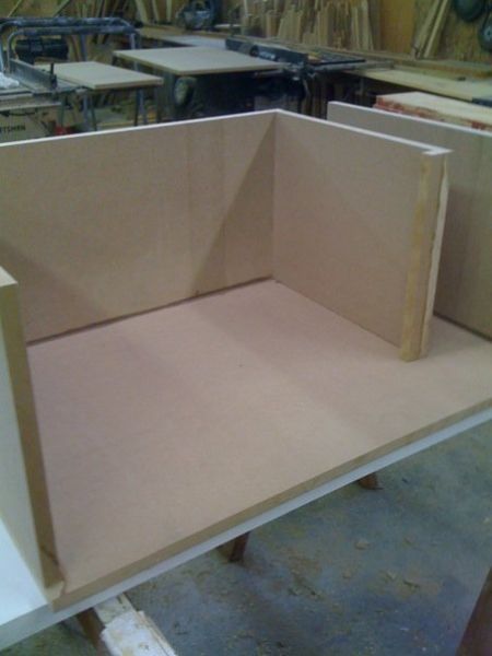

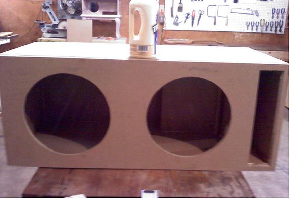

built a box yesterday fora local for 2 type r 12s. box is around 4.4 cubes net, tuned to 35hz. i forgot to take pictures, as do i everytime i build a box. i should have because it would show it off a lil better. but the dude managed to snag a few pictures while i was making it. hope you guys enjoy, lemme know what you think.

looks good. Nice shop.

thanks dio... we own our own cabinet shop. i was brought up into cabinetry. and box building really is a passion. but yeah, shop is pretty nice.

looks good, what glue did you use?

i use titebond.. in one of the pics u see some brown stuff, itscaulk. didnt want ppl to think it was a bad cut.. haha i had to show the guy what caulk was. didnt even know what it was.. :S y u ask what glue i use though?

eric, I asked what you used just because i saw the dark stuff and I thought maybe you were using gorilla glue so I was just asking. Looks good though.

ohh nahh, not gorilla glue, although i have thought about using it. it was some caulk..

very clean box man. i jus built a box friday almost identical to the one u built expect mine was 4.3 cu ft net and tuned to 36 hz. i used titebond 2.worked great.
