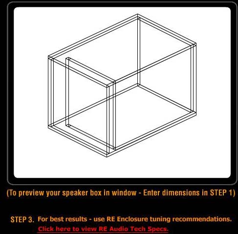

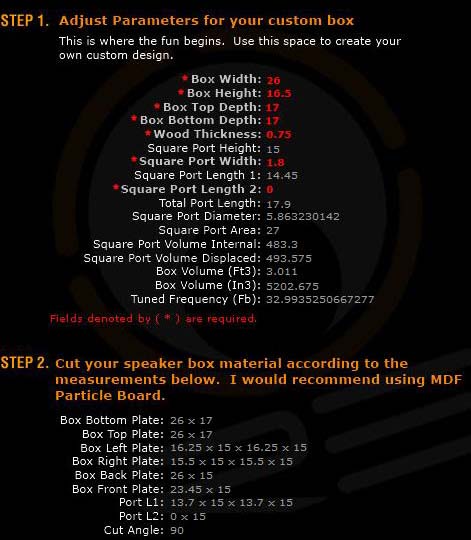

Silver Member Username: Jd93kidBrandon, MS U.S. Post Number: 211 Registered: Jul-09 | ok.. so i kinda just need to know if this will work for an rd sonance v.2 15" sub and if increasing the volume to 3.1 would make a difference.. I also need to know what the cutout diameter for this sub is.. ![]() |
Gold Member Username: Dustin3D&L Audio Tech.Dustin Post Number: 5105 Registered: Oct-05 | I would have more port area and a bigger port width than the 1.8" you have there. The cutout diameter should be in the manual. |
Silver Member Username: BoomtankRochester, NY USA Post Number: 632 Registered: Oct-06 | I have 2 Sonance v2 15" subs. 6cu^ft at 32hz with 120i^2n of port face. I would try and get 3 cubes with around 50-60in^2 of port face. They are amazing subwoofers |
Silver Member Username: Jd93kidBrandon, MS U.S. Post Number: 214 Registered: Jul-09 | alright thanks how wide do you suggest i go on the port |
Silver Member Username: Jd93kidBrandon, MS U.S. Post Number: 215 Registered: Jul-09 | Do you think this would be better.. http://i464.photobucket.com/albums/rr1/jd_01101993/boxdim.jpg |
Silver Member Username: Jd93kidBrandon, MS U.S. Post Number: 216 Registered: Jul-09 | my bad.. i was misunderstanding but i have to fit this in my trunk and i measured the biggest i can fit in my trunk is 16.5 X 17.5 X 27 so the most in^2 i can get is about 37.. |

Silver Member Username: Jd93kidBrandon, MS U.S. Post Number: 231 Registered: Jul-09 | alright.. i am.. but hey do you guys think 41 sq in of port face is enough for one RD Sonance v.2 15 |
Gold Member Username: TurnmatWww.j-designs.org Post Number: 1233 Registered: Feb-07 | That should be good. Normally you want to have 12-16" of port area, per cu ft of airspace in your box. So a 3 cu ft box would have between 36 and 48" of port area. |
Silver Member Username: Jd93kidBrandon, MS U.S. Post Number: 232 Registered: Jul-09 | ok.. just making sure because up above someone mentioned 50 - 60 sq in of port.. thank you for clarifying tho.. It wont have any distortion or anything right? I'm just tryin to be safe so i dont build it then it not work.. |
