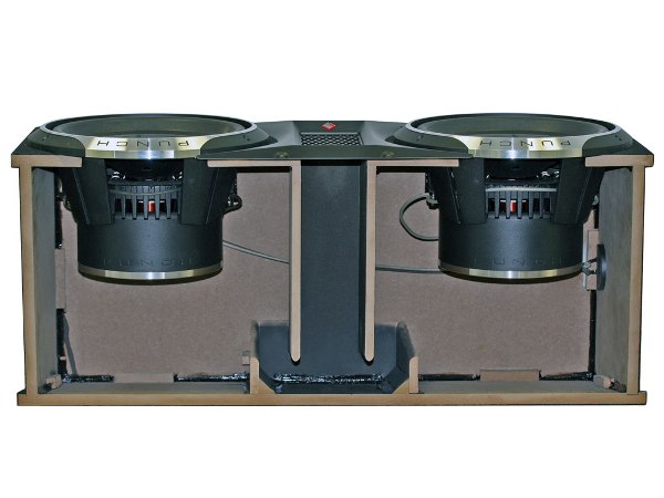

Bronze Member Username: Nickadam55Post Number: 51 Registered: Feb-09 | Okay so will it be best to just do a solid enclosure no port no nothing or i think i might try to duplicate this box(pic) which will sound better![]() |

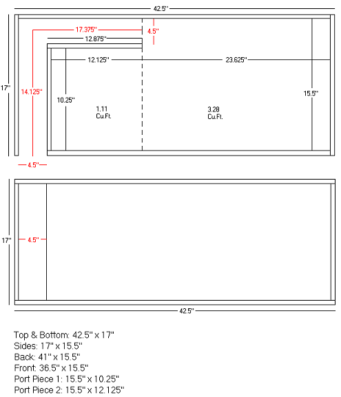

Gold Member Username: Hittin1TEAM REVOLUTION, La. Lake Charles... Post Number: 3838 Registered: May-07 | i would go ported, but there is no need to try and duplicate that build. there are plenty of different designs that would work.. what mono amp are you going to use? make/model you will need an amp that puts out ~500 wrms at 2 ohm (either 2 ohm stable 500 wrms amp or 1 ohm stable ~1000 wrms amp would be most common) you do not really need he center divider. A common chamber enclosure would do fine with a mono amp since both subs will be getting the exact amount of power from the amp. It looks like you will need ~4 ^3 ft tuned to ~35-37 Hz. not knowing your max dimentions I found you a box design that would work if the box would fit in your vehicle. If not let me know your max dimentions and I can find you a design or make one up real quick. ![]() |
Gold Member Username: Hittin1TEAM REVOLUTION, La. Lake Charles... Post Number: 3839 Registered: May-07 | btw I was going by RF powerful box size recommendations... they can go in ~1.25^3 ft each if space is an issue. |

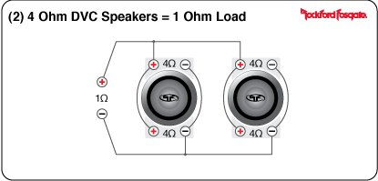

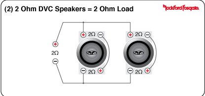

Gold Member Username: Hittin1TEAM REVOLUTION, La. Lake Charles... Post Number: 3841 Registered: May-07 | how are you gonna run 2 subs that are dual 2 ohm v.c at 1 ohm? you can only wire both of them @ .5,2,and 8 ohm. if your amp puts that much power at 1 ohm, it will work great if you wire your subs at 2 ohms. |

Bronze Member Username: Nickadam55Columbia MO, Missouri Post Number: 57 Registered: Feb-09 | No i have 4ohm voice coils mark. Fosgate leans more tword sealed box but said it really dident matter. thanks |
Bronze Member Username: Nickadam55Columbia MO, Missouri Post Number: 58 Registered: Feb-09 | sorry i meant P3D412s |
