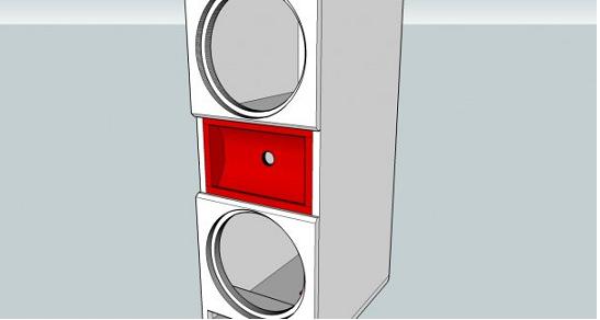

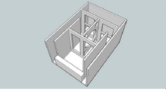

Box for custom designed 18" that will be underneath the stage.
Custom box for the mains (2 12's w/ horn)
Username: Dustin3
D&L Audio Tech.Dustin
Post Number: 5089
On the mains, there are two ports (which you can partially see in the design)

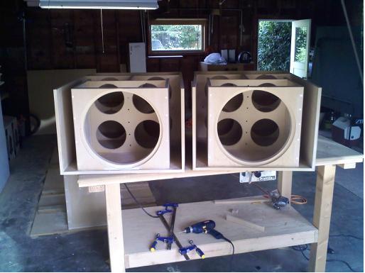

The mid-bass drivers are eminence delta 12b's and the compression drivers are selenium 220ti-8's mated with a selenium exponential horn. The x-over will be a 3rd order linkwitz at 1.6kHz that im making. The enclosures are 1.75ft^3 (per chamber) at 65hz and will be used with a 4th order butterworth at 60hz for the high pass

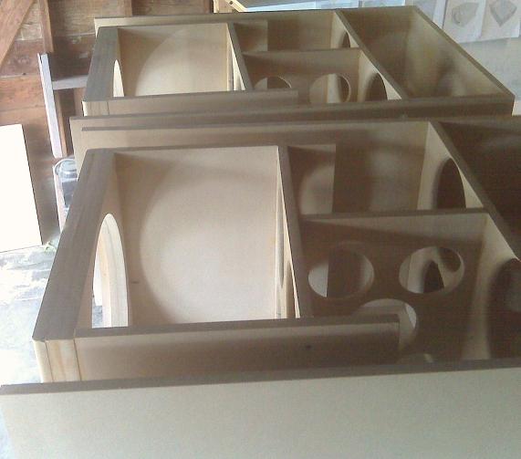

here are some build pics

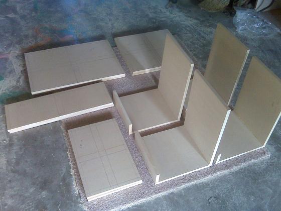

all of the pieces layed out (five 4'x10' sheets)

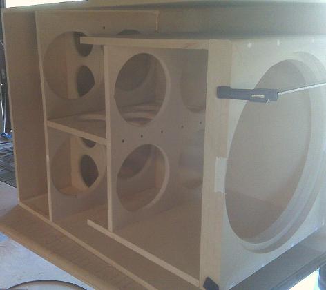

Thanks guys. More pics:
Username: Dustin3
Post Number: 5091
we still got alot of work to do. Still got to prep. the boxes for our finish. More pics to come.

Thanks. We used a combinations of programs but mainly unibox, google sketchup and used Winisd for the projected spl levels etc

Username: Tatonka
-[Team Audible Insanity]-
Post Number: 3135
I see those braces hurting your air flow.
Other than that it looks good bro.
Username: Dustin3
Post Number: 5093
How you figure Nick?
Username: Dlavante
D&L Audio Tech. , Daniel Tigard, Or, USA
Post Number: 236
It shouldn't restrict it too much. The brace directly behind the sub has a little under 800 sq cm of openings to the rear of the enclosure, which is about 210sq cm less than the surface area of the cone. It will restrict it somewhat but I seriously doubt the difference will be audible

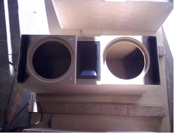

Alright guys,
Basically we have been sanding and puttying for a couple days straight (seems like it) and the boxes are all ready for the finish. The boxes came out perfect, exactly how it was designed. You can't feel any seams or holes for all four boxes. Here are more pics: :-)
before all the sanding
ports painted
Put the horn in to see how it will look.
Boxes all done, ready for the finish
In the morning were going to put the first layer of finish on the boxes and we will be done by tomorrow evening... Hope you like em'

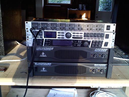

We have another amp thats not in this pic.

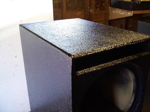

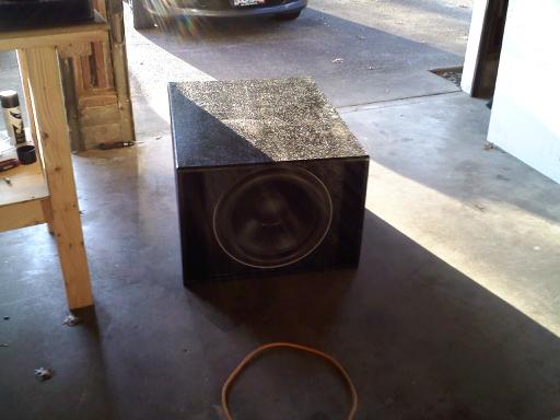

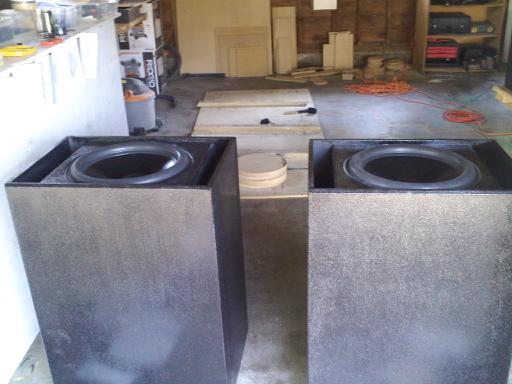

Mains done.
gotta love XLR'S
Username: Dustin3
Post Number: 5112
So we tested everything out at a couple local Fraternities and they sound AMAZING. By FAR the best system i'v heard at any club. The mains are very loud, clean and crisp and the subs blend in with the mains perfectly. For our demo's we like to play the subs at full potential for a couple songs to see what the people in the house think. When we do that they are completely amazed. We've been around subs for a while and when we had them hooked up in the basement of a frat house at full volume I was shaking a little afterwords. So loud that chunks of the ceiling were falling down. We have a total of ~ 13k going to everything and we couldn't be happier with how everything turned out. enjoy!
