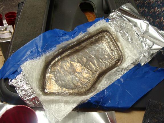

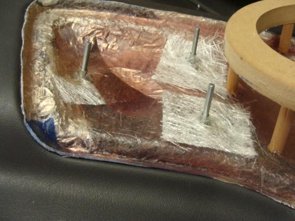

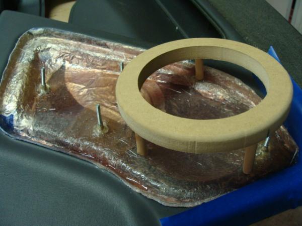

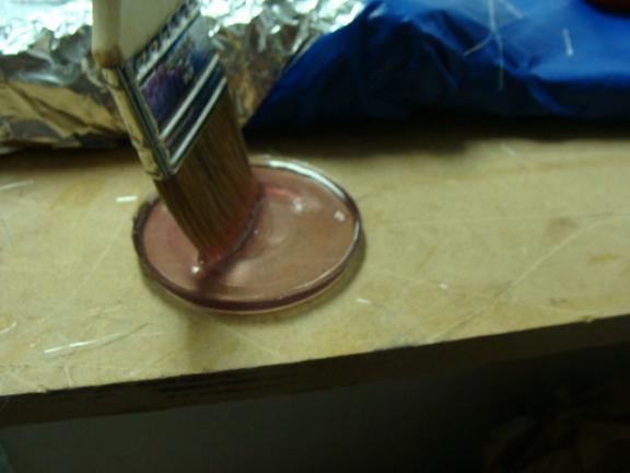

Gold Member Username: SouthernrebelMonroe, Louisiana Team Audible... Post Number: 7566 Registered: Mar-04 | Well, I have been without a system in the Avalanche for FAR too long, so I have started the build. Here is whats going in: Eclipse 7200mkII DD C4a DDA 6.5's mids DDA T28 tweets 2 DD 3515E in 6th order thru midgate 1 IA 20.1 (until I can get another amp) 2 or 3 Deka 9a31 All Xscorpion wire and interconnections And a little Second Skin Damplifier Pro Here is a little start on some pods for the front doors: Sorry, didn't get any pics of the start of the mold, I will on the drivers side though. ![]() Drilled thru the door panel and mold to get some T-nuts in place. This will hold the pod on the door. ![]() ![]() CA glued the T-nuts in place on the inside of the mold. ![]() First layer of mat and resin on the T-nuts. |

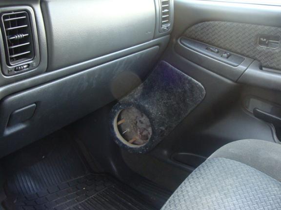

Gold Member Username: SouthernrebelMonroe, Louisiana Team Audible... Post Number: 7567 Registered: Mar-04 | ![]() Teeth on the T-nuts should bit into the mat pretty well. ![]() Didn't get the angle the pods as much as I wanted. Checked em out in the truck and this is as far as I can go, any more and glove box would hit the pod when opened. ![]() Second layer of mat on the T-nuts. |

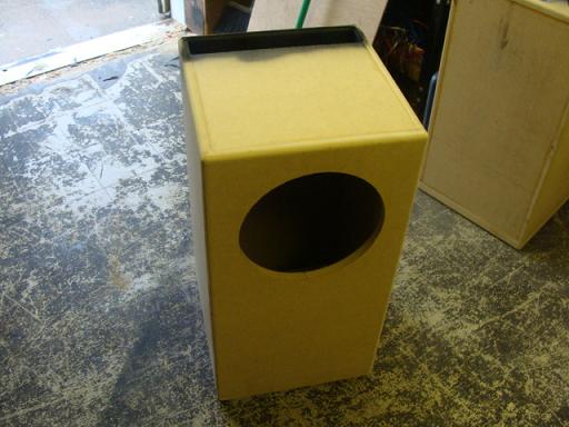

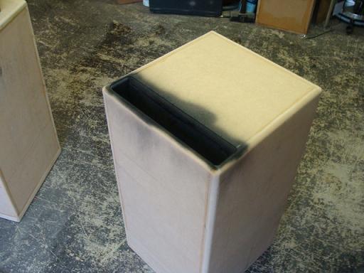

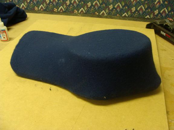

Gold Member Username: SouthernrebelMonroe, Louisiana Team Audible... Post Number: 7571 Registered: Mar-04 | Progress today: ![]() ![]() Single 12" box for a customer's JL w7. 2.25cuft tuned to 33hz. Didn't get a pic of it carpeted w/ the sub mounted. ![]() ![]() Fleece. |
Gold Member Username: SouthernrebelMonroe, Louisiana Team Audible... Post Number: 7572 Registered: Mar-04 | ![]() ![]() ![]() Waiting on this layer to cure, its a rainy day so may take a while. |
Gold Member Username: SouthernrebelMonroe, Louisiana Team Audible... Post Number: 7573 Registered: Mar-04 | ![]() ![]() First layer of mat |
Gold Member Username: Big_edge_headMilwaukee, WI Post Number: 3976 Registered: Mar-07 | Coming along nicely. I love putting resin over the fleece, it soaks so much up lol. |
Gold Member Username: Tatonka-[Team Audible Insanity]- Post Number: 3059 Registered: Mar-07 |
That's actually a disadvantage of fleece...lol |
Gold Member Username: BernymacPhnom PenhCambodia Post Number: 4707 Registered: Sep-04 | ^^ yep. It doesn't make it any stronger because its thicker. The mat is what makes it stronger. |

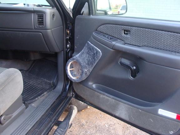

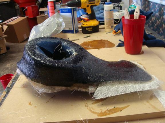

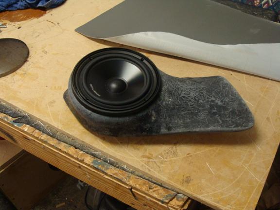

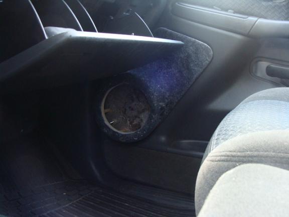

Gold Member Username: SouthernrebelMonroe, Louisiana Team Audible... Post Number: 7574 Registered: Mar-04 | Well, got the passenger side shaped and ready for a little body filler. ![]() ![]() ![]() ![]() Test fit again w/ the DDA w6.5 ![]() Mounted to the door panel to show how it fits. That is the vinyl im going to use, just need to grab a heat gun to help stretch it. ![]() Popped the door panel in. ![]() ![]() Its close, but the glove box can open fully without hitting the pod. |

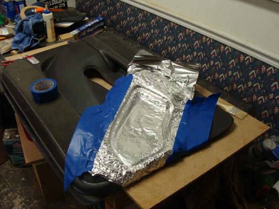

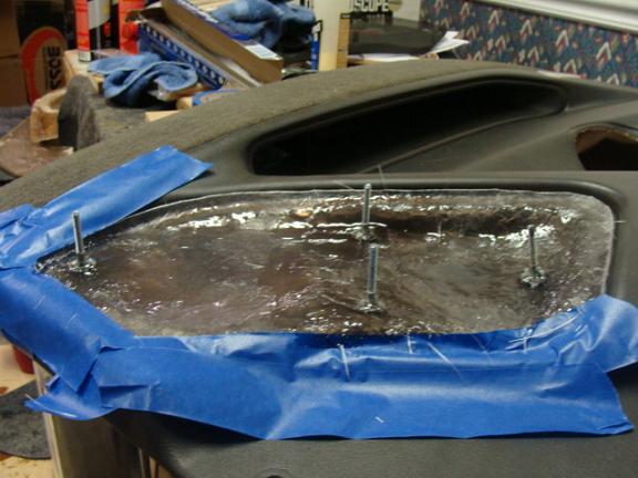

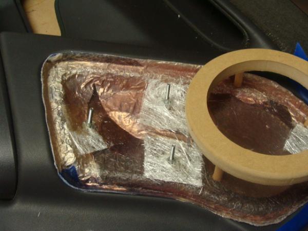

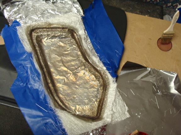

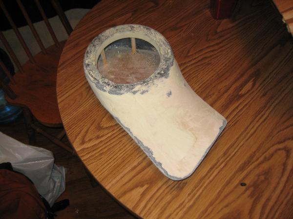

Gold Member Username: SouthernrebelMonroe, Louisiana Team Audible... Post Number: 7583 Registered: Mar-04 | Got started on the drivers side today: ![]() Trying a little something different on the drivers side. I had to sand the passenger side so dam much after fleecing to make it fit, so I did 8 layers of aluminum foil on this side. Hopefully that will give me enough gap to allow far less sanding on the edges once I fleece it. ![]() ![]() ![]() ![]() ![]() My super cool FG-artwork. ![]() |

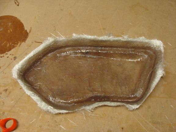

Gold Member Username: SouthernrebelMonroe, Louisiana Team Audible... Post Number: 7584 Registered: Mar-04 | Pulled the mold off the door panel: ![]() ![]() ![]() Pulling back the foil and getting ready to trim it down. ![]() ![]() ![]() Got most of the foil off. Going to wait awhile to trim is down w/ the air-saw, the top layer of mat is still a little gummy. |
Gold Member Username: SouthernrebelMonroe, Louisiana Team Audible... Post Number: 7585 Registered: Mar-04 | The mold drops right in and seems to have given me the slack around the door panel that I wanted. ![]() ![]() Hope that is enough gap for the fleece and some 2 layers of mat. (its a bigger gap than the pic makes it look) |

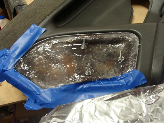

Gold Member Username: SouthernrebelMonroe, Louisiana Team Audible... Post Number: 7587 Registered: Mar-04 | ![]() Drilled and t-nuts seated in place. ![]() A little mat over them to hold in place. ![]() ![]() Waiting for it to cure. |

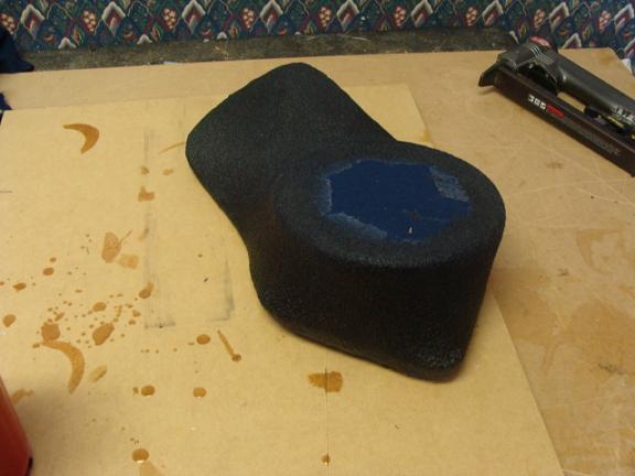

Gold Member Username: SouthernrebelMonroe, Louisiana Team Audible... Post Number: 7588 Registered: Mar-04 | Body filled the passenger side pod ![]() ![]() ![]() ![]() New toys. Heat gun to help stretch vinyl and a sprayer for contact cement. |

Gold Member Username: FrkkevinTeam DLSSuperNatural... Post Number: 7094 Registered: Nov-05 | thats a lot of damn filler.. why didn't you flush mount? |
Gold Member Username: SouthernrebelMonroe, Louisiana Team Audible... Post Number: 7589 Registered: Mar-04 |
I just coated the whole thing and hand sanded it w/ 80grit. Did it at home and it was a *itch, should have just waited and done it at the shop tomorrow w/ my palm sander ![]() As for flush mounting, I really wish I would have but this was a little easier to cut. I may end up going back and redoing them later on. I just wanted to build it and get my truck up and running. I'm going on vacation on the 11th and want to have it playing for the trip. |
