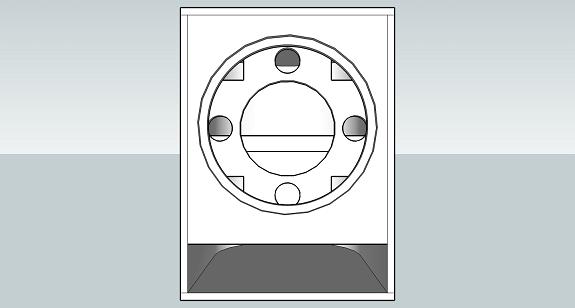

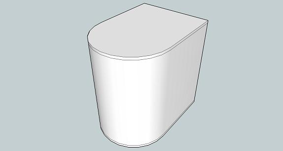

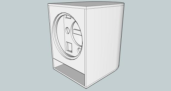

The specs are 7.5 cubes at 38hz. We got some testing done yesterday but tonight and tomorrow are going to be the real tests. A local dj will be using it an event for 4+ hours tonight and tomorrow night it will be demoed for a local club looking for some new subwoofers

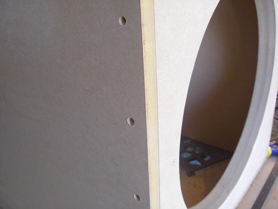

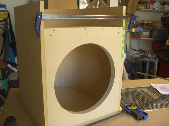

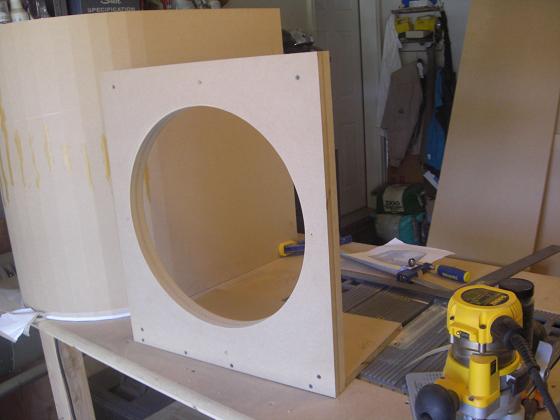

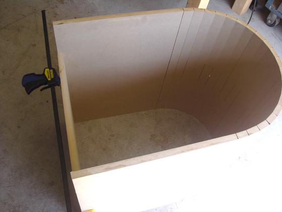

We also resined the whole inside of the back wall (where the kerfs are)

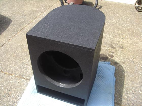

Looks very clean.
Specs on everything?... subs, box, etc.

Post Number: 220
18" modified BTL. 7.5 cu ft net. 38hz. 168lbs total weight. It will be powered by a Behringer EP2500 The amp has been tested at 1900-2100wrms at 4ohms. The lowpass will be set for 125hz and the subsonic set at 35hz, both at a 12db/oct slope. still needs handles but we didnt have to time get them from PE

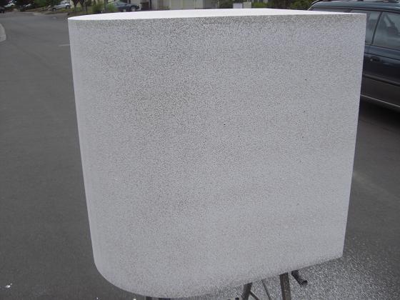

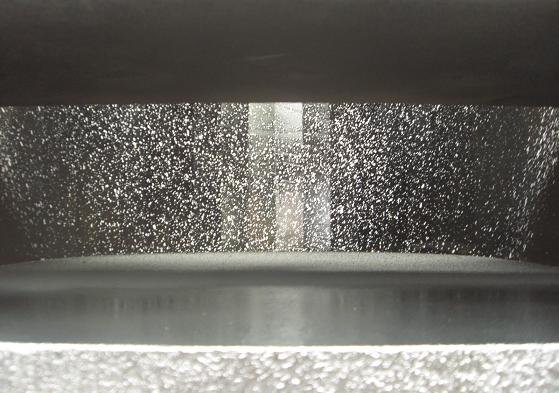

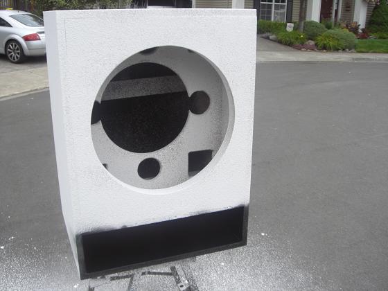

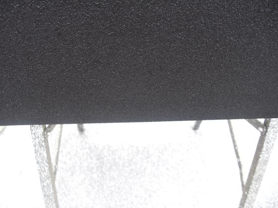

im also really impressed with that behringer amp. It ran all night while only getting warm to the touch, and the clip indicator never came on. the only problem im running into now is the finish
