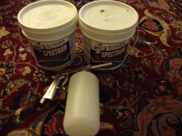

I ordered 2 gallons of Spectrum just to see what it was like and help get a really good coat on my doors. I ordered their spray gun for it because I hate using a brush for large areas, and a roller seems like I would waste a lot of material.

The equipment going in:

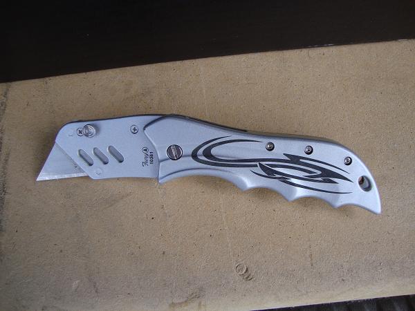

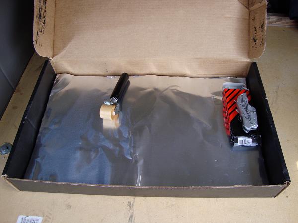

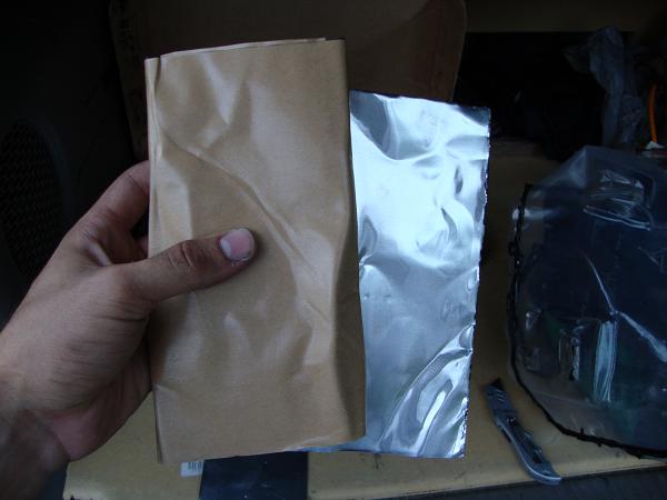

The sound deadening products: They were nice enough to throw in a roller and Fury knife. The knife is very ergonomic and has been working great compared to some of my old razor knives.

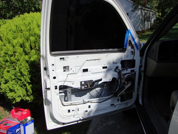

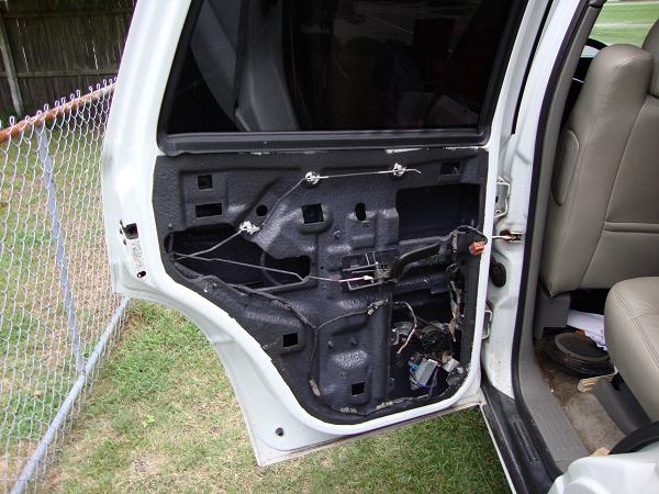

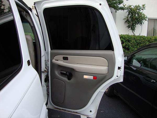

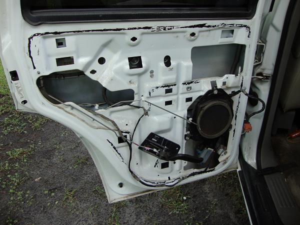

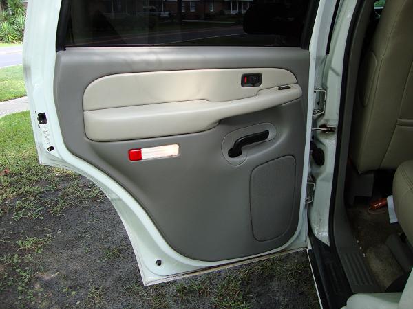

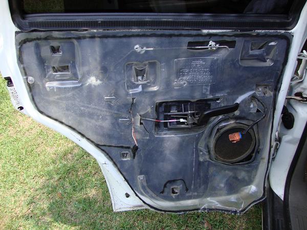

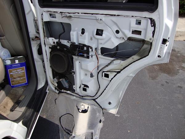

The door before removing the panel Panel removed, only 3 bolts then pull up to remove it.

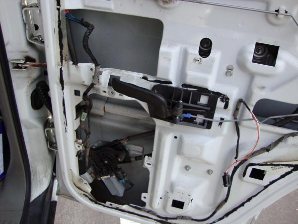

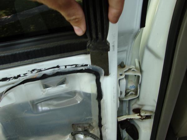

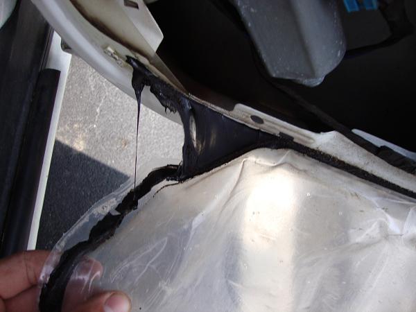

Pulling the plastic off, this black adhesive is reusable, I'm trying to save it but god does it stretch.
Pulled off

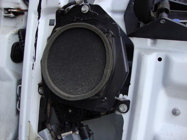

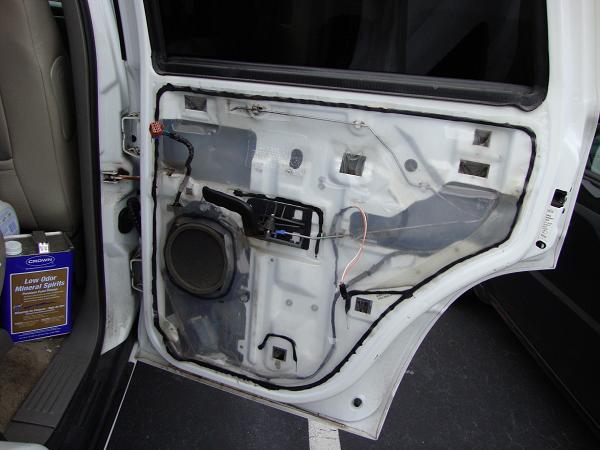

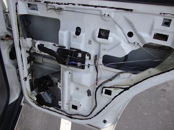

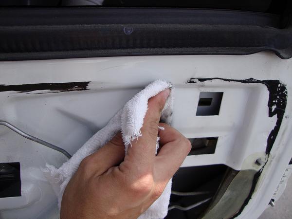

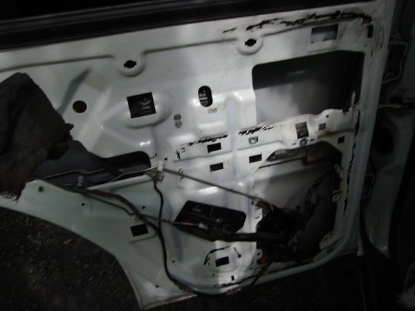

The whole speaker is attached to a huge chunk of plastic I haven't decided what I'm going to do as far as sound deadening this goes- I'd rather build a wood mounting for an e8 or something to go here. . Cleaning the black glue stuff with spirits. Huge hole to work with

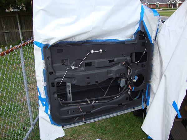

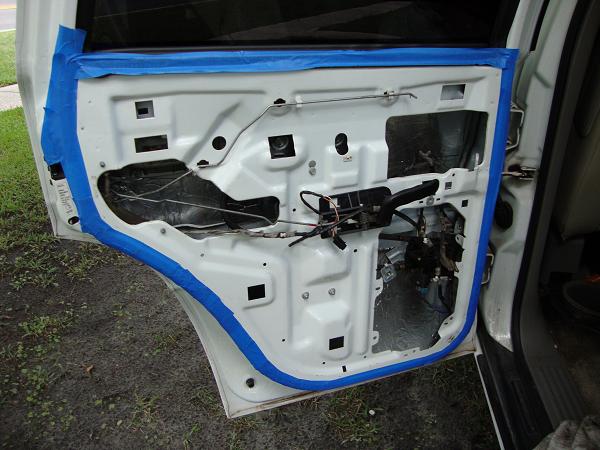

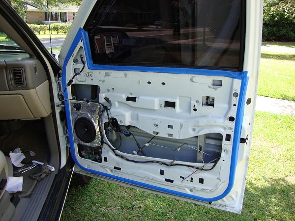

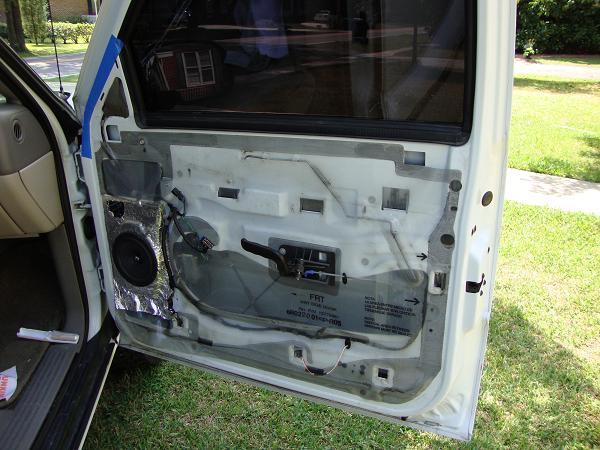

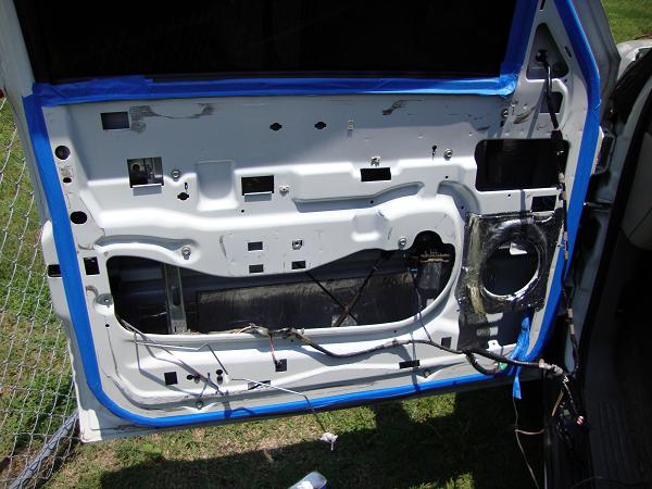

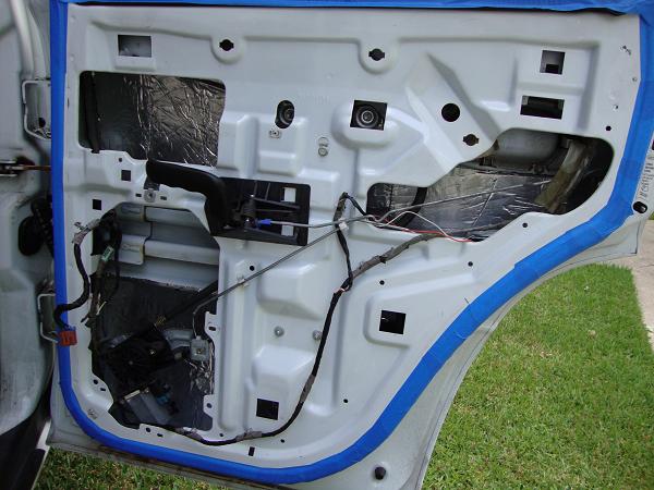

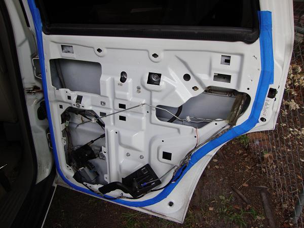

After fully cleaning the entire treatment area I popped the panel back on and taped off a border where sound deadener would become visible. I will be doing a bit more when the time comes to use the spectrum.

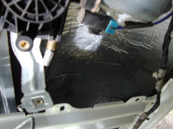

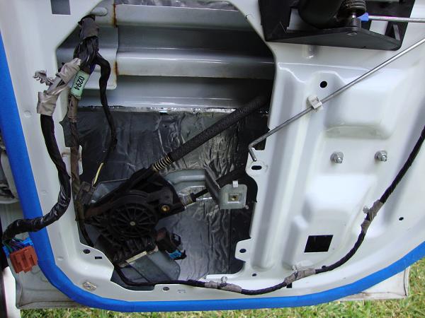

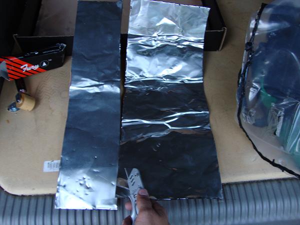

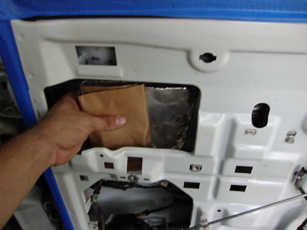

The door kit came with 8 sheets of mat, so I decided to use 2 per door and use the spectrum to make up for anywhere I ran short. Cutting the first piece to fit the outer metal first. I like to roll it up and start a corner of the back adhesive layer so I can fit larger pieces inside the door. Very very impressed with the adhesive, but after being in the sun a bit it even stuck to the paper lol.
So this is one full sheet. At this rate I would suggest to anyone with a full size truck to expect a door kit to cover a set of doors with one layer, not all four.

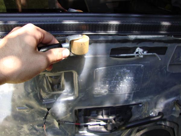

Not a problem Paul. If it wasn't for the eminent rain I would have stressed using the roller to ensure good contact, but I was in a hurry the last few minutes.

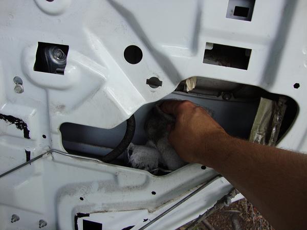

Inside the door you can only do so much before you just end up shoving your finger tips into the crevices to push down the deadener. I wont be doing that much since I got the liquid to make things easier for myself.

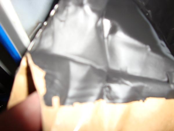

Cut one sheet in half to make it easier to install. It fit really well though.
You can see I didn't get any of the curved areas with deadener, and that's fine. I'll be using the liquid for the curves and saving my hands- and honestly the bends give the metal rigidity. The large flat panels are the noisy ones.

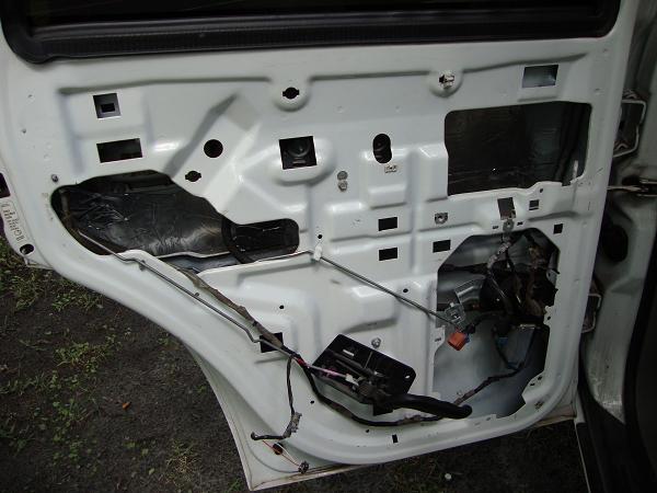

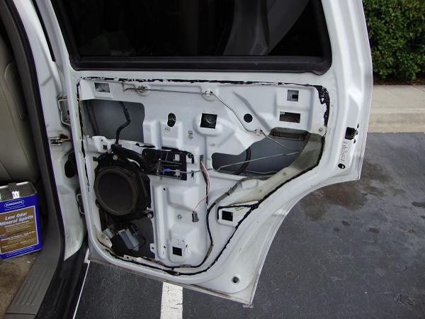

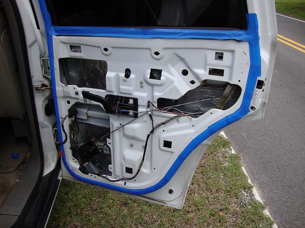

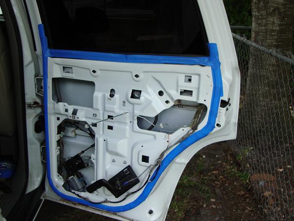

Today I finished up the rear 2 doors. It looked like rain so that's all I got done, but I'm pleased with the results. Still took a few hours with as much cleaning/prep work went into it. On to pics:
The rear drivers side.

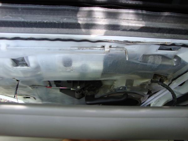

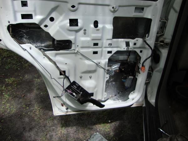

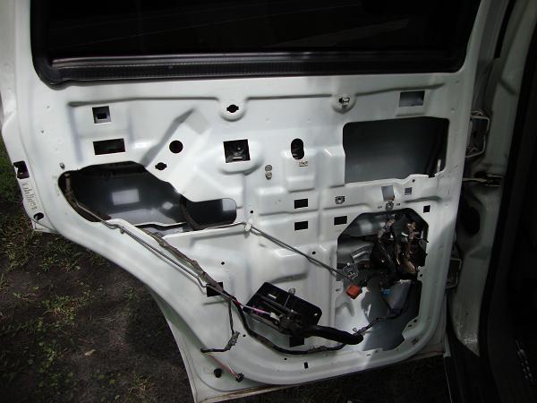

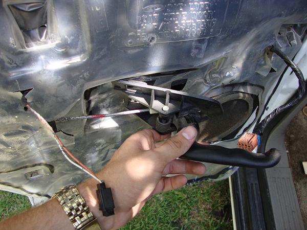

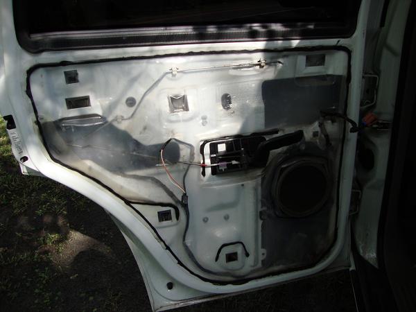

Pulling the panel, you have to detach the clip for the power windows and I just pull the light bulb out entirely. Scraping as much adhesive as possible before just pulling it off seems to minimize the amount left on the door.

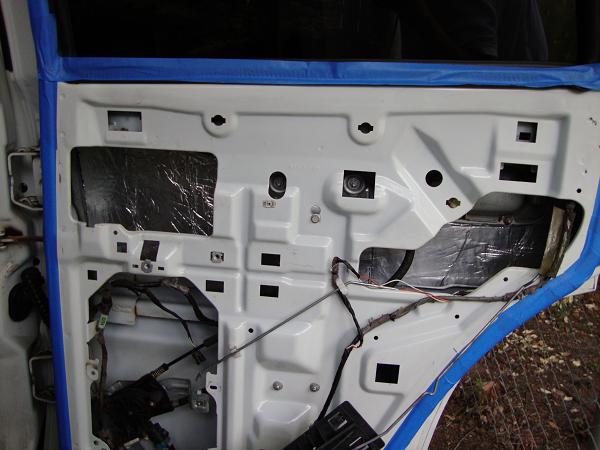

First sheet of sound deadener on this door installed.
Second sheet on the lower portion.

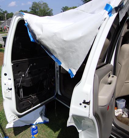

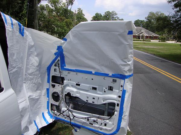

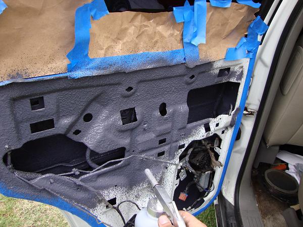

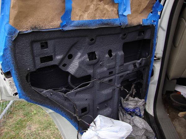

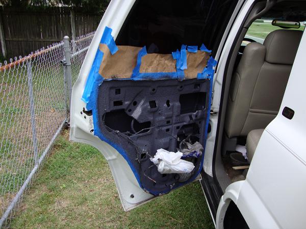

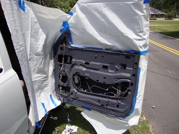

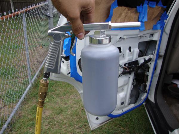

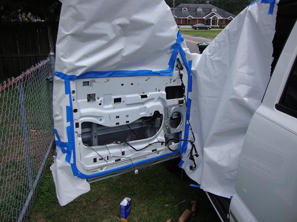

Getting ready to start spraying the rear doors. 80psi on the sprayer, one full reservoir is 1/4 gallon.

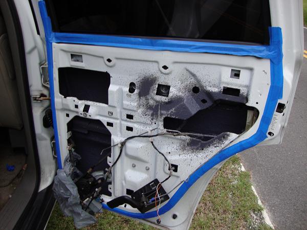

Started the first coat. I used grocery bags to protect the door handle and motor for the window.
Using Spectrum on the passenger side rear.

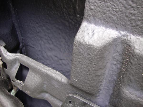

Much better for corners than mat imo.
Back to the drivers side for the second coat.
And a second coat on the passenger side.
Putting the panels back together.

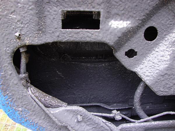

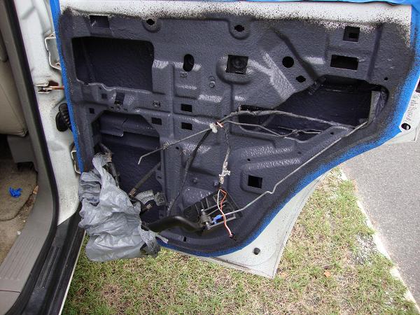

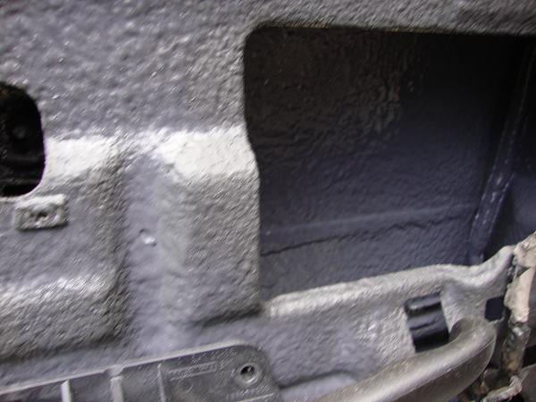

When wet it has a sandy texture, and looks grayish.
Passenger door put back together.

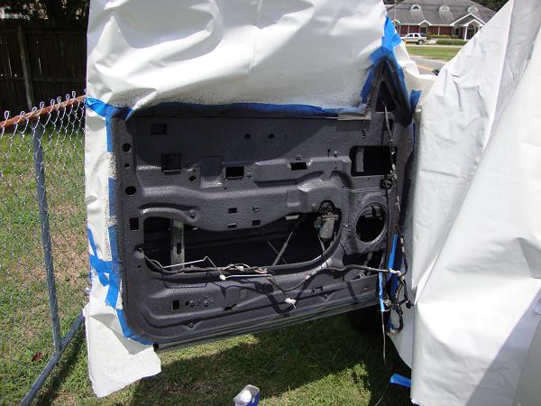

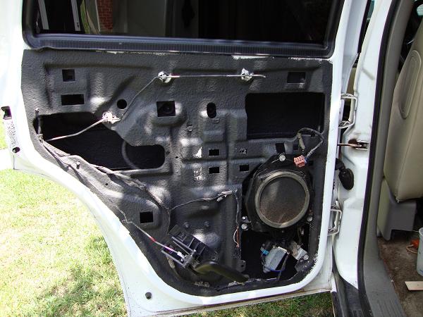

Around 1-2mm thickness per door.
I used 1/2 of a gallon, exactly as I hoped to. After 4 hours there were some spots still not all the way dry, so it sits overnight. There was an odor, but it was not very strong.Overall I'm pretty pleased with, the two treated doors sound so much better than before.

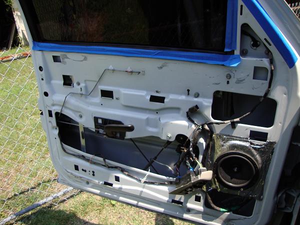

Anyway, I'm not posting this for both doors, just one because it's the same process. I'll do the front doors this week as time permits. I REALLY want to do some 7" mids or even a set of e8s in those rear doors - it's 8.5" of clearance and I could make 4-5" of depth... I don't have 200rms per channel at 4 ohms though
Pics:

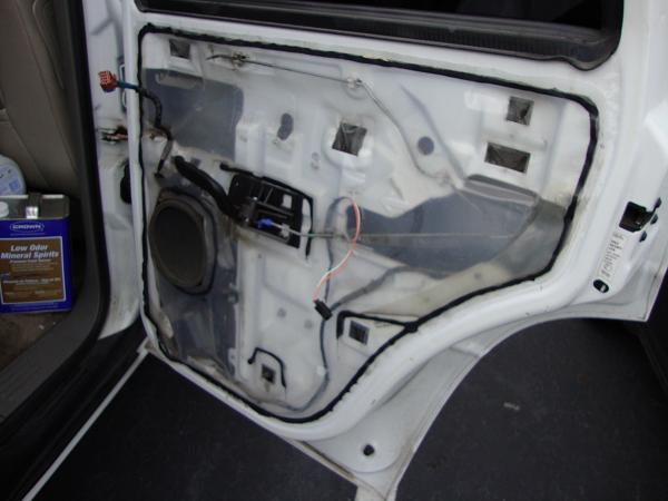

Factory speaker re-installed and all wires clamped in place.
I put the moisture barrier back on, letting the door handle hold it in place while re-adhering.
pop out the wires and push the plastic in place by hand.
The wood roller works great for pressing this on- it holds great because of how much excess there was from the factory (it stays soft).

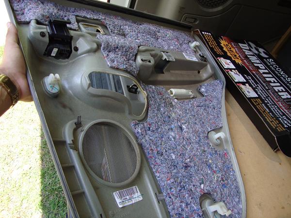

I did this because my panels have this factory material that is like carpet padding, and it absorbs water like a sponge. When I popped the panel off after a good rain there was a bit of dampness on things, so better safe than sorry.

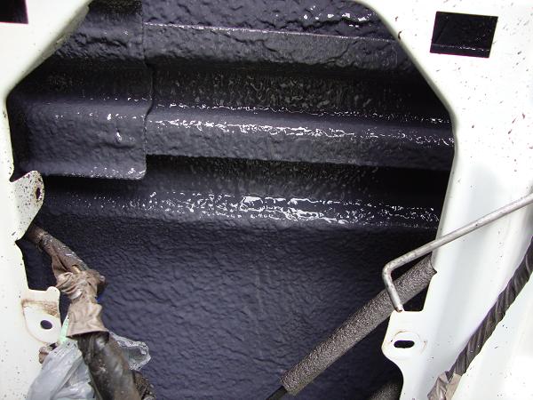

Final thoughts: This stuff is awesome. Pros: -Much quieter inside the vehicle- less traffic noise -Better bass response from the 6.5" driver. I was listening to Placebo and actually heard bass from my front doors, which was almost non-existent before. I had my x-over set around 65-70hz just because it sounded like crap before, just to find out it was the vibrations sounding bad, not the driver. Now I have to adjust my amp and see what I can get out of them. Solid thud when closing the door, it sounds 'sturdier' if that makes sense, higher quality. -The damplifier has such good adhesive you can not leave it in the sun because it will separate- sticking to the wax paper. I put mine in the freezer for 10 minutes before installing just to get it off the backing without issue. After you put it in place there's no chance of it coming off though.
Cons: There was about an inch of solid stuff in the bottom of my gallon jugs- roughly 1/2 a quart. So one quart of unusable mass between the two jugs. This was not left sitting, this was unable to be stirred as soon as I opened the container, like it was already hardened. I tried everything to get it usable and it was just waste. The gallons weren't left uncovered and were stored in my house at 72degrees. Still worth it.
Overall a great product, good service, and I will never use anything but spectrum unless damplifier becomes cheaper. It's soooooo easy to spray in door panels compared to trying to roll mat out to adhere. I can see where it's a little difficult to get even coverage on strange shaped surfaces, but it's easier to install in hard to reach places, and faster (imo) than fighting with mat. I just don't like rolling mat on.
