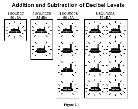

Here's a good pic describing the concept. By adding drivers it's just like adding power, but not doubling output, only increasing it "slightly". Hope it helps.

"so if you double the wattage its only gonna show a 3 db increase?"
Yes.
"So lets say my friend was hitting 60dbs before he adds 3 more tens and lets just say they have 60dbs at 6 ft because its in a blazer he would only have a DB increase of 18dbs?"
No. The subs don't actually have any dbs inherently. Just look at it like adding 3 decibels every time you double the quantity of subs. From one sub to two = 3 db higher, from two to four = 6 db higher. So if he was hitting 60db he would now be (theoretically) at 66 if he had one sub. If he has 4 subs now adding 3 more would gain him less than 3 db.
I've never seen a car with a sub meter lower than 100db, unless you are talking about 6 feet outside the vehicle.
"would the adding of subs and a non increaseing power supply bring down the gain is spl?"
Not usually. Both subs should be getting the same signal from the amp(s), so by increasing the number of subs it should continue to get louder.

To gain 9dbs you need to either have 8X the original power or drivers.
Say you start out with one 100w sub hitting 100dbs.
103dbs requires 200w or 2 100w drivers.
106dbs requires 400w or 4 100w drivers.
109dbs requires 800w or 8 100w drivers.
Seeing as it's usually easier to run a one sub setup alot of ppl opt for the higher powered single sub setup as opposed to multiple drivers, just to keep it simple.
Think of the concept like filling up a martini glass with water, or vodka, or everclear or whatever. As the cup's diameter widens it fills slower and slower with the same rate of water flow. If the depth of the water in the glass represents dbs you can see that with every inch of water rise (db) it takes more water (power) to do so. At the top of the glass it takes MANY more units of water (power) to achieve the same increase in height (dbs) as when you first started filling it.
This is why record setters/holders HAVE to run 10's of thousands of watts simply to gain the few more dbs required to attain a higher score. Power plays a big roll but at that level efficiency in design, product and execution are just as if not more important than muscle.
