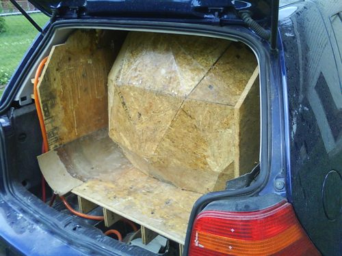

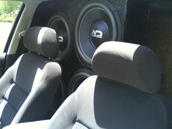

the subs close to the port are wanting to freeair because they are so close, the left and right side are working against each other so much it amazing it even makes a sound.
that and the air leaks around the gasket on the subs r really bad also
so right now it sucks!
just thought i would show u what im putting in
ill show u my high db numbers after i get everything takin care of

wtf?
try all subwoofers equal distance to the port to solve your problem.

There is a much easier back wall design that will give you the desired effect!

this is the front of it.

so i guess u guys dont think the dome is a good idea

all you need is a slant...

i am at 154.1 now still with the subs out of phase

basic wall with 4 DD 15s local burps in the 155s on just strapped saz1500ds ... @ 59hz
street beat avg on 30 sec is a 154.9 for whatever music he is using that don't sound like music.. thats going to change with new rules for street beat tho
Username: Frkkevin
Team DLSSuperNatural...
Post Number: 6900
also.. NON wall s-10 with 8 cheap crossfire 10s and two crossfire 1400 watt amps.. 155.9
all this effort and you could be doing those numbers with a much more simply design
remember.. "KISS"

I understand the concept you were aiming for but it has been proven years and years over again that it is ineffective. If you did a standard wall built well I assure you, you could put up just as high of numbers and more.
The concept of a ported box is to aim all the air out in one direction, I understand that with doing the angles that you are trying it will "smoothen" the air flow but it will not do as good of a job at directing.
my suggestion once again would be a standard wall with a slant on the end opposite of the port.
^^^this :-)

dblk: when i firt saw your build in the back of this (is it a dodge... something?) i thought " wow, he is boarding up the whole back end of thatcar and is gonna have ~20 cubes of airspace. that is gonna be some serious streetbeat."
then you fudged it up, and made a goofy looking box.
im no pro, but that doesnt look like it could have any advantages as opposed to a normal ported box.
my suggestion? if you dont know how to b build a box ported for 4 15s, just make it sealed, because the amount of money you'll spend on wood trying and trying again would just depress you if your shooting in the dark hoping to get big numbers.

how have i fudged this up?
i now have two back baffles, the dome and a normal on that is about 9 inches thick (really strong)
a geodesic dome is strong just because of its design.
what i have found to be true is that in MOST cases rounding off corners makes things louder, i have also found that boxes that are not the normal "box" shaped can do even better if they are made more rounded. i watched a pair of 10s with 2k watts hit a 147something and when i looked at the box i had to laugh. this guy made boxes out of pvc and propane cans, along with some other cool ideas
the only person i know of that has even built a wall on this site is canaan, some of the funny shapes in my box i can't help because my car is not a van. i am just making it the subs as close to each other as i can so i can have the largest port than i can,
now with many different change able ports and two different back baffles i will find out what is really best for my car and what i have.
the 4 dd 15s that did a 155, good job. i am looking to get a little louder than that. and i am limited so tuning to 60Hz or much higher is going to call for a box 17cuft or less,
i really think that the dome will work best because it is strong, and i can make my box bigger with it. and more than anything i really think the shape will help.
if im wrong then at least i tried and i still have a different baffle that slides right in,if im right then it payed off,
what ever happens i am learning from it, it seems like many of u don't like to try new things
canaan and jack, can u show me a pic of a slant like ur talking about? i might have a port made that does what ur saying but its not togather and im not sure if what u say and what im thinking is the same

the slant is the back of the wall itself.
Here's the thing, you are not trying anything new. There have been many people before you try the funky dome back wall and other random stuff, and all have failed, miserably.

Look at all of the top speaker companies that make loaded enclosures... None of them use dome backs. That in itself is enough for me not to do it.
Its cool if you want to mess around with box designs, I had a phase where all I did was make isobaric boxes. However without proving the numbers you really have no credibility.

i think you are over engineering this whole build bro. lol.i would start over.....with a steel cage, birch, and pieces you can put in the box, test them, and if they dont work, pull them out. and if they do, make them permenant.

About that domed back wall, domes are strong from the outside...NOT the inside. They are actually VERY week on from the inside.

Didn't this all start out to be a walled musical daily driver?
um....60hz+ tuned ported b-pillar wall does not = daily???

if u or any one has an idea for my wall tell me.
all i am getting is ur dome sucks, ur build sucks
some of the funny shapes i can not change because of the size and shape of my car. so i am limited, i would bet much better off with 4 12s other than 15s but this is what i have,
ya.. i wanted a nice musical wall... now i don't care i just want to win in my class at finals

tonight I can draw up a wall build for you, can you give me rough dimensions so I can at least give you a good idea of what would work best

perhaps you got the hate because instead of asking first.. you did it anyway.. then asked after :-)

dBLK, there are tips posted in every thread that you make. You usually do the opisite of what is suggested. If you dont take the offer that Matt just proposed. then you would be the biggest fumduck possible.. And the whole point of optimizing the equipment that you are using is to build the wall to specs for your equipment and not just put the subs as close as you can to fit the biggest port possible.

if it is a box shaped i can only have a 9 inch long port side to side and less if i double up the wood

^^^ matt if u just made a regualr ported box that gave u just enough room to see out ur back window u could prolly have a system that would knock walls off other ppls systems
