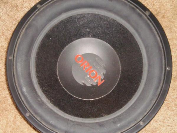

Bronze Member Username: D2freakPost Number: 18 Registered: May-09 | got my new sub today, really excited... tell me what ya think, I gotta hook this thing up to test it out ![]() |
Gold Member Username: JakeyplaysbassSt. Louis, MO / ASU Post Number: 3621 Registered: Jul-05 | Looks like an old XTR if im not mistaken. Pretty good subs off ~300watts. |
Bronze Member Username: D2freakPost Number: 19 Registered: May-09 | it's the 99 series HCCA 15D2, rated at 1200watts (well re rated, originally rated at 600) |
Gold Member Username: JakeyplaysbassSt. Louis, MO / ASU Post Number: 3622 Registered: Jul-05 | Even better, congrats man. |
Gold Member Username: Hittin1TEAM REVOLUTIONLake Charles... Post Number: 3446 Registered: May-07 | great sub. |
Platinum Member Username: Rovin1 15 = 149.5 DBs ...Trinidad & T... Post Number: 15130 Registered: Jul-05 | old hcca is some good old skool stuff ... |

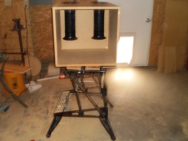

Bronze Member Username: D2freakPost Number: 21 Registered: May-09 | I built a box for it, cheesy, but it's to test it see how it sounds before I throw it in a nice box ![]() |
Bronze Member Username: Woofers4lifeLexington, Tennessee Post Number: 86 Registered: Mar-09 | nice box tell us how it sounds. |
