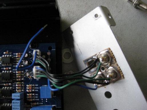

Broke my RCA cable's connecters in the input to the amp and like an idiot, didn't think before snapping something attached to the end of the bolts inside the amp...
When I use the other RCA slots the gain/filters are useless and it plays all frequencies and at a set volume.
Home fixable with some soldering? Or should I spend the money to have it fixed and can it be fixed?
Anyone seen this happen before? lol

took the amp case off and all it looks like i need to do is solder the wire back to the bolt.
Heres the real problem. The RCA ends are stuck in the holes. I have no idea how Im going to get them out. Ive tried sticking numerous objects in the hole to try and pry it out with no luck.
Ideas anyone???Upload

My friend recently did the exact same thing. Drill a hole in the snapped off rca piece with those really thin bits that do not seem to be good for anything. Be careful not to drill to deep.Try to back it out. If that does not work, dip a tooth pick in super glue, and insert it in the pre-drilled hole, be careful not to touch the sides OPERATION! LOL)let it bond, and pull out slowly. Hope this helps.

Ty for response but I ended up comming up with the exact same solution. Soldered the wire to the end and I should be good to go. Just need to get my sub back from my friend who I let borrow it...which hes prolly ganna duck my calls LOL
