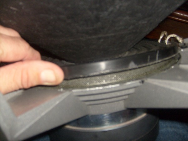

This sub was recently reconed from Rd Audio. What is the best repair/fix for this or would it be better to send back to RD.. What epoxy/glue is originally used to connect the spider? I will contact
Steve before I make any moves, but just wanted to hear some opinions... Thanks

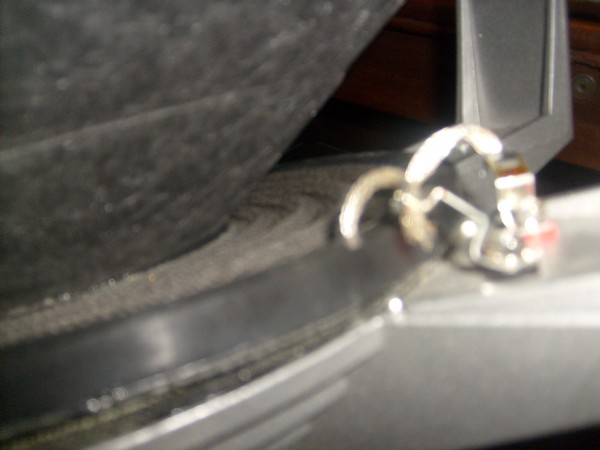

why does it looks like its burnt?

Somebody forgot to run the screws in the ring.
#6 3/4" will work to fix the problem, sorry man!
Let me know if you got any problems after you screw it down.

ok. Just talked to Steve. The Alpha should have about 6 screws(every other hole) holding down the spider ring. It seems the person who did the recone only used two screws. I should have her wanging in about an hour.
Snow, It is the camera.I assume you are referring to the tinsels. They are both the same color in person. It does appear that one looks darker in the photo..
