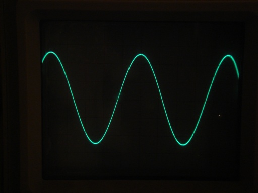

It is called clipping because when an amplifier is sent a signal with more voltage or current than it's power supply can produce, it "clips" the top of the sine wave off, which then becomes square wave distortion. Basically speaking -- clipping occurs anytime an amplifier is sent a signal it cannot supply enough current to reproduce.
Note the clean peaks in the first pic below and then the same waveform, but clipped, in the last pic. An example of the sound of this type of distortion (although obviously at a much higher level) would be when a rock guitarist intentionally clips his amps output by overdriving the pre-amp, and sending either a vacuum tube or transistor more voltage then it can cleanly reproduce. Another example of clipping is when you turn a clock radio higher than its amp (and/or speakers) can handle.
