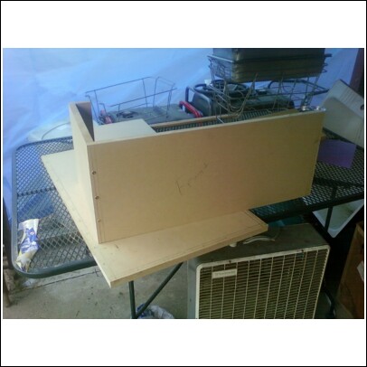

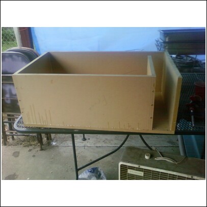

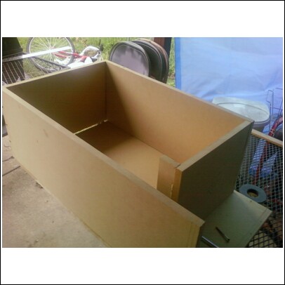

Gold Member Username: B3n07Louisville, Ky USA Post Number: 1042 Registered: Jul-07 | So i just got arround to building the box brockman designed me using the re site an here is how it has cam so far tell me what youll think ![]() |
Silver Member Username: TylerslivaSt.Ignace, Mi U.S. Post Number: 246 Registered: Oct-08 | looks good so far is this the first box you made |
Gold Member Username: B3n07Louisville, Ky USA Post Number: 1043 Registered: Jul-07 | nope its my third, but it is the first i have shown on E. im tring to decide if im going to use a 2x2 an brace the box from the inside |
Platinum Member Username: Rovin1 15 = 149.5 DBs ...Trinidad & T... Post Number: 14928 Registered: Jul-05 | which sub\s is\are going in this ? specs & tuning ? ...... |
Gold Member Username: Drant19DUB-C, TX Post Number: 1567 Registered: Aug-07 | i have that same table lol oh and why did you cut off the port length? in the first 2 pics.. |
Gold Member Username: B3n07Louisville, Ky USA Post Number: 1047 Registered: Jul-07 | rovin the box is for 2 12 L7 tuning is 36 hrtz at 3.5 cubs net abarca the piece was glued on in those pics an i thought i need to screw to hold it and it split right down the middle it only changed my tunning about 1 hrtz so figured it was no biggy |
Gold Member Username: Hittin1TEAM REVOLUTIONLake Charles... Post Number: 3161 Registered: May-07 | i remember throwing the design out there for him, but I forgot what the subs/specs were. I hope it works out for him and doesn't look too bad atm. It was the frst time I used that particular box designer. I always used BB6P. Keep us informed, Ben.. I am gratefull that you would use my advice, ect... I love this site. lol |

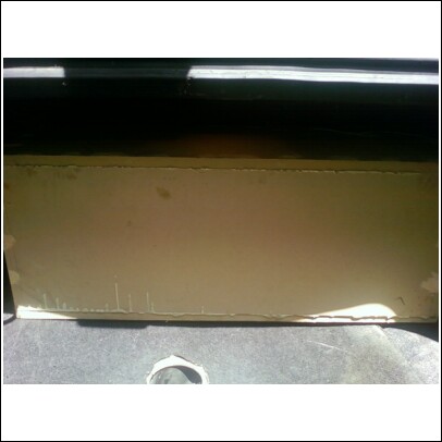

Gold Member Username: B3n07Louisville, Ky USA Post Number: 1060 Registered: Jul-07 | here is two pics from the front and one from the trunk ill try to get a video up im not sure where i will host it |
Gold Member Username: Hittin1TEAM REVOLUTIONLake Charles... Post Number: 3227 Registered: May-07 | youtube or photobucket work well. i was just wanting to see the excursion if the camera can capture it. did you try turning the box around... That is the norm for trunk cars. Usually it is noticeably louder. |
Gold Member Username: B3n07Louisville, Ky USA Post Number: 1061 Registered: Jul-07 | i did try to reverse them i think its louder facing forwards. when facing backwards i hits the trunk lid alot harder |
