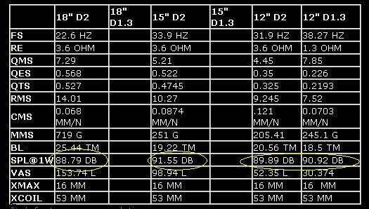

I was wondering what the efficiency of the 15" Alpha V.2 is? Is it 91.55?? if so why is the 18" less efficient? arent the bigger subs more efficient? Is it a typo?
And are the D1.3 more efficient than the D2?? as shown on the 12" specs
Thank you

the 18" used for them t/s was made to be very musical and had a very high MMS.

Oh ok so then the 15" D2 is rated at 91.55 DB efficiency? does that mean that the D1.3 is rated a bit higher?
Oh wow yeah the 18" has way higher MMS...what is MMS hahaha sorry

MMS = moving mass

So what is the benefit of having large mass to move?

When we put the diff soft parts on the Alpha to increase the mms it sounds warmer and goes lower in hz.
We have soft part options for higher spl that can still go very low.
