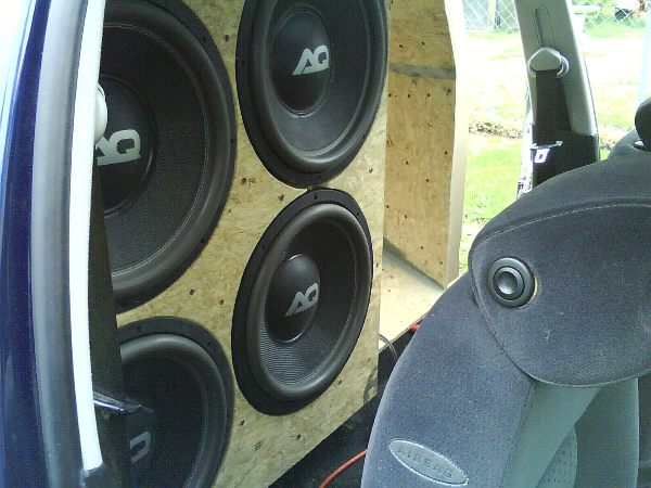

i put the subs in with just a few screws to make sure my front baffle would fit over them ok.
front baffle
with out front baffle
wit front baffle on
so its 3 layers thick now. i am going to make one more layer that goes on the inside. and im also thinking about doing an other one over the front baffle i just made. idk if that would look cool or stupid

Looks loud!
Looking good though.
Username: Andrew35
Post Number: 26
Registered: Oct-08
that looks pretty awesome as of now

I don't know about you but having the subs spaced different amounts from each other would bug the sh!t out of me...like how you had to cut in one place because they are so close then left the other...I can't stop looking at the picture and its driving me crazy

hahaha. i really thought i was going to have to cut all the places like that! haha
if u really want when i go over it with the fiberglass ill make it look like it goes all threw.
up front i got a nine 2x amp powering some 6.5 M6s for the mids and aluminum cdt tweeters for my highs

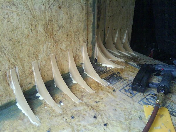

this thing is going to have a lot of threaded rod going in for braces!

i am leaving those braces like that for now. i might add on to them later. we will see. i am running out of time
jk! u ask what hz ill burp at???? is there any way to even know what will be loudest? my last had a hit note of 50Hz and the box was tuned to 40Hz.
this wall is going to have a back baffle that slides back and forward so the volume of the box will change. i will also have 2 back baffles that are different shapes. so ill be able to change the volume and tuning to find what is loudest. plus! ill make a few ports so i can cut on that also. i have no idea what volume it will end up being or what it will be tuned too. less that 30 cuft and between 40 and 80 Hz???? thats my guess

now for the braces ya coulda gained more cubic foot with different style bracing...

Username: Southernrebel
Post Number: 7426
Registered: Mar-04
I see about 15 things that are going to KILL your #'s.
A major one being all those fukt up angles in the box.
Who the hell did u say was helping you on this build?
Who told you to build it like this???
Username: Deadrabit
Marionville, MO
Post Number: 1618
rick told me the angles. and lee said he didn't know what it would do if anything. jermy L told me to place the subs and port like this
15 things??? please make a list! and post it! if i agree with any of them ill change it now. and i would like to change now other than wait until its painted and looking pretty

-every joint in the box seems weak.
-not properly mounted to the vehicle (the wobble you were talking about).
-minimal to no actually cross-tied brasing (all braces seem independent, no support from each other)
-the 500 jagged corners will obstruct airflow
-3layer baffle actually has VERY little support, (look at getting some threaded rod at least)
-sloped floor at the base of the port side will make your tuning all nutty.
-particle board???
Should I go on?

canaan-
how do my joints seem weak?
its mounted in the car very well.. or will be when i get that far,
im not done with my front baffle. it will be 4 layers thick with fiberglass and have many threaded rods for bracing.
ITS NOT PARTICLE BOARD! ITS ADVANTECH!
can u explain the corners? if it is what i am thinking about it is were i am rounding them off.
the sloped floor has had me wondering. if u saw the early pix of the build it was different. but i had to have one side sloped and the middle sloped some so the subs would fit.
do u think i should try to take the slop away? look at how my subs set and tell me what u think. i do konw that i should prolly do something about that.
canaan i don't mean to sound like i think i know everything. u have done a lot more walls than me! but i think everything u have said i already had planed to fix im just not that far into it yet. other than the front slop. what would u do on that part?

it didn't rain today. i have had lots of home work. but i smoothed this out and got some foam in it

canaan dont even bother we have tried to explaining that this wall is not good but he will not listen...
Username: Deadrabit
Marionville, MO
Post Number: 1662
i listen. but i don't understand whats not good other than the front angel

Username: Deadrabit
Marionville, MO
Post Number: 1667
i have to ask! have any of u actually tried angels like this??
Username: Andrew35
Post Number: 30
Registered: Oct-08
i havent. but with things like this you'll just learn how to do it better.
Username: Deadrabit
Marionville, MO
Post Number: 1669
well if no one has tried it maybe it will be even better.
i mean no one on this forum has used this kind of wood either. so i guess it is a big test in a lot of areas

ya hunter... after my mission trip i thought it would be much better if i could give my box wings
Username: Rovin
1 15 = 149.5 DBs ...Trinidad & T...
Post Number: 14924
i bet u found out that foam is some messy sh1t to deal with ...
i agree with andrew - this guy aint steve meade & im sure steve didnt do it right the 1st few times
im sure its a great learning experience & he will learn far more from trying this in real than reading what some person online did
go strong bro ...

Username: Deadrabit
Marionville, MO
Post Number: 1671
ya. if it doesn't work ill learn from it
it was the first time i used foam... it wasn't bad... then i came out an hour later and it GREW! haha. i thought it was done but it just kept getting bigger. it is great for what im using it for. but next time i wont use a full can for one corner

Username: Deadrabit
Marionville, MO
Post Number: 1676
well i sure hope i get a 154. my last box sucked and keep in mind i was over 150 with it. and now i have 3 times the power.
my last box was single layer mdf. it had some flex! and it was not all the way sealed from the front.
i don't think that one angle is going to make it be off that much ! and in the place its in i really had no choice. it was either that or make the port a lot smaller
