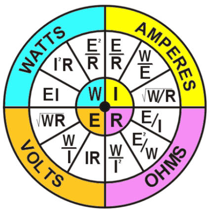

Sorry to highjack, but I got a question for you Paul..
Terminal volts X 10 gives you the wattage? And do you just set the wattage to rated RMS?

Right, so he was running 10 amps current? Where would i measure my amp draw? Power to ground?
