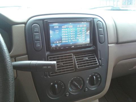

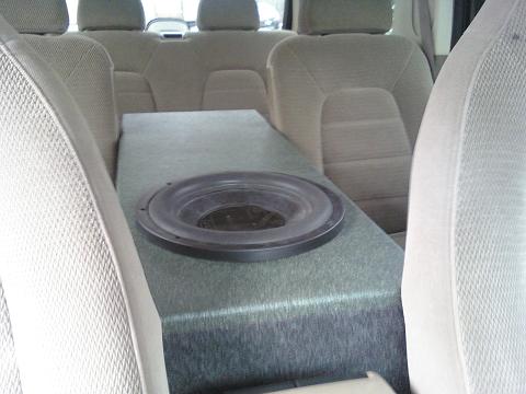

this is my new box for my 12" alpha v1...the box is tuned to 34hz 3.2cuft the bottom part is carpeted and the top half is sprayed with a textured spraypaint and has routered edges...the amps are under the sub box and are a 1750.1 running at 2ohm until i get my other alpha reconed to run it at 1ohm and a pa gothic series 2 channel running two infinity 6 1/4 in the doors...also is picture of my jvcavx800...Upload

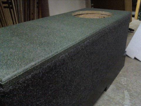

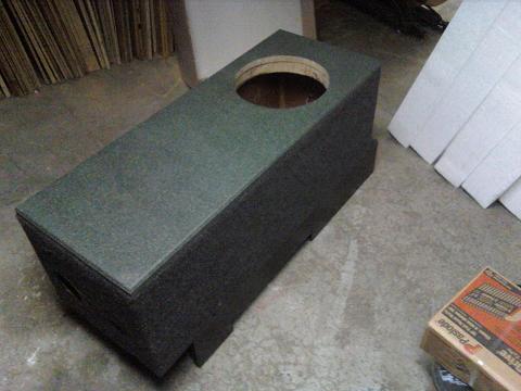

more pics of the box while i was spraying it at my dads warehouse...Upload

what kind of van is that in?
looks GREAT! i really like how to did that!
what did u spray it with?

thanks alot, its a 2002 ford eplorer xlt...the spray was
http://www.rustoleum.com/CBGProduct.asp?pid=31
very easy to use, jsut filled in all holes and sprayed a black base coat then 3-4 coats of the textured then 3-4 coats of clear...i loved how it turned out, im probably giong to spray my whole box with it when i build the next one...
