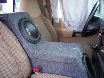

Ok well I Stuck with 3/4 plywood, It was a personal Preference, and now she is complete. Again I would like to thank everyone, I'm highly satisfied with the RE Sr's.
[IMG]http://i123.photobucket.com/albums/o293/saturdaynightride/subs.jpg[/IMG]

Plywood box = fail
Everyone else uses MDF for a reason.

plywood is no good to many holes. Rebuild the box with MDF it will sound so much better

Here it is. Not too much you can do with a single cab ranger. Upload

Looks real good. But you should be using MDF instead..
