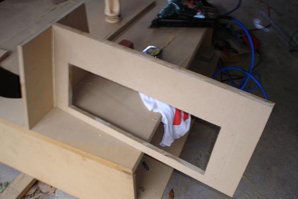

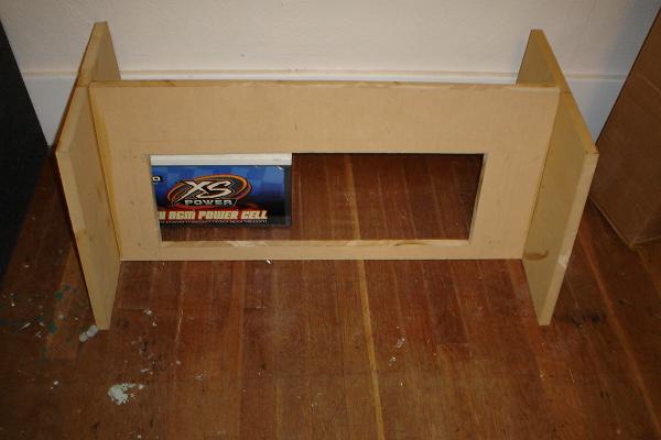

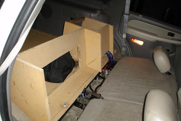

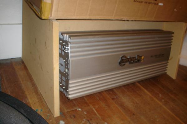

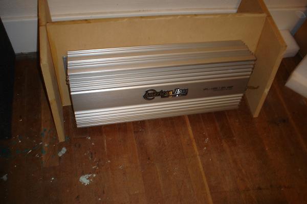

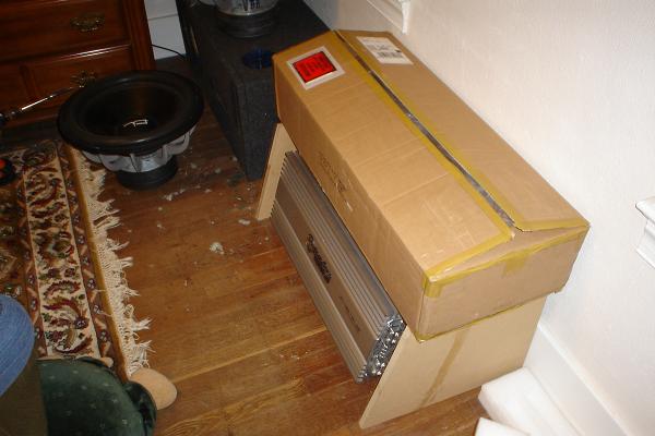

Gold Member Username: TejcurrentPost Number: 1764 Registered: Apr-07 | Finally got an hour or so into my build. I've been trying to figure out a way to position everything so it would fit and look really nice. This is a really rough skeleton of the amp/battery rack. This is about 32" of the final 49" it will be. I will have: 5 Powermaster D3100s 8 runs of 1/0 (4 + 4 -) at least 2 alternators, currently 400a total, probbaly go to about 750/800. Using Mechman atm 2 Fi BTL 18s- going to 22s when they're out Realm 6.5 components Eclipse 4ch American Bass 1000.1 Should be updating every other day or so when they don't keep me 12+ hours at work like they have been. Really really unfinished, but I plan on carpeting it black and having everything flushed in real nice. It's hard to imagine but that's why it's a build log. That box in the corner there is a ported box for a 12" type-x and hifonics 2006d- just to give you an idea of realative size. Piss off about the ghetto room though- house is a work in progress too lol. More tomarrow or Tuesday night. |

Diamond Member Username: WingmanaliveWww.stainles... .ecrater.com Post Number: 20053 Registered: Jun-06 | Nice! Said it b4. THAT is one nice amp. Be careful. ![]() |

Silver Member Username: WickedbassNashville, Tn Post Number: 440 Registered: Jan-08 | Lookin' good man! Love that amp.![]() |
Gold Member Username: Basebalz13Moneta, Va Usa Post Number: 1146 Registered: Aug-07 | yeah he should be good tho, 2 500.1's 5 D3100's and a single mechman alt like him i wasnt seeing too much of voltage drop, each amp was at 1 ohm so basically its the same electrical setup as him so he should be good and ya i cant wait, 2-4 18's in a s10 should be LOUD lol ![]() |

Gold Member Username: MendonmafiaUSA Post Number: 1754 Registered: Aug-06 | this thing is gonna be a low rider just from the system lol. ~500lbs for batteries and wire ~100lbs box ~110lbs Subs amps gotta weight damn near 50 lbs thats like rollin with a full ride at all times. |
Gold Member Username: Basebalz13Moneta, Va Usa Post Number: 1150 Registered: Aug-07 | amps is i believe 69 correct me if im wrong troy |

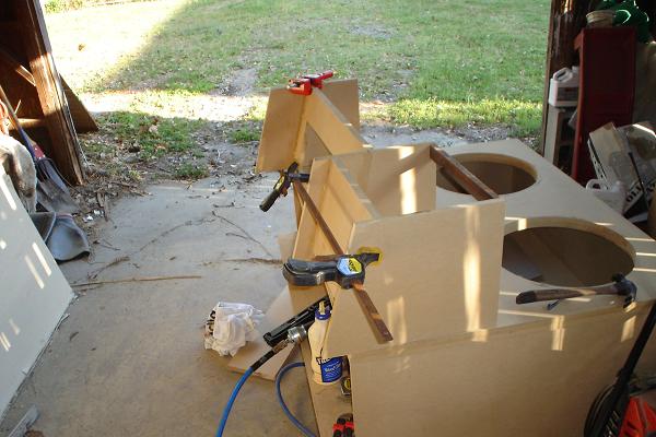

Gold Member Username: TejcurrentPost Number: 1767 Registered: Apr-07 | You are right D-money I got this truck for the tow package + 4x4 so it sits level once everythings in. The last system was around 20cubes net, this is more like 10-11. There will be several boxes instead of just one- I want to be able to do 2 subs for daily/comps, but be able to pull one out when I've got baby stuff to haul around. I can't carry a 10-20ft box with 2 subs in myself, but I can carry individual boxes. Thanks, I started college classes that are going to keep me from doing work tonight, hopefully tomarrow. I'm making sure I have everything planned out perfectly. |

Gold Member Username: DeadrabitMarionville, MO Post Number: 1413 Registered: Jun-07 | i would make 2 boxes for sure. then u can have both unless this is for comps tune it low if u just make one. when some one sets in ur car and listens to it high they will think its really loud. if some one sets in ur car with it tuned low they will po op there pants i know every one will say im not right but i would make the box a littlemore than 5cuft persub. and for ur spl box the port opening much bigger |

Gold Member Username: TejcurrentPost Number: 1771 Registered: Apr-07 | I don't want to do those yet, I'll be doing some kerf cuts. BLK, I think with as much power as they'll be getting over 5ft would be a mistake. I love you too andrizzle damn j/p j/p lol, but thanks a lot. Sounds like 34hz it is. |

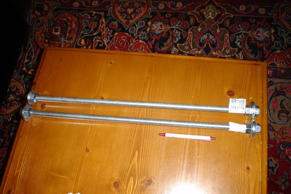

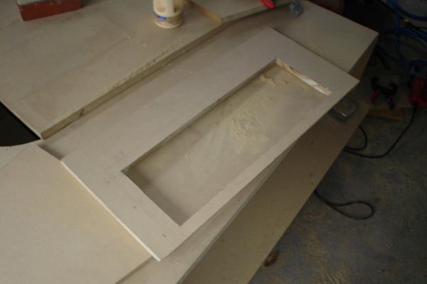

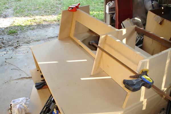

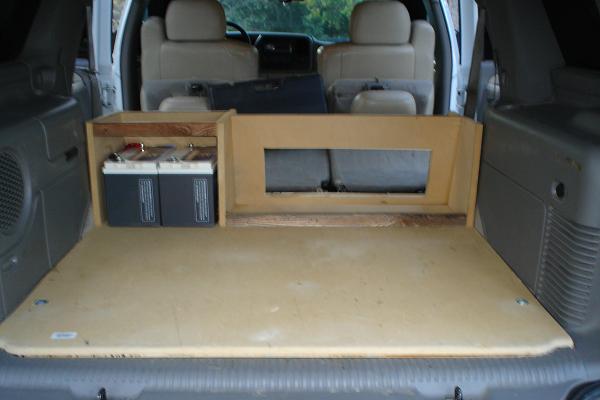

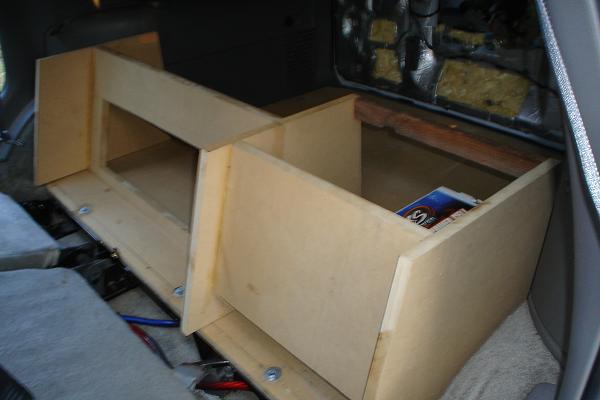

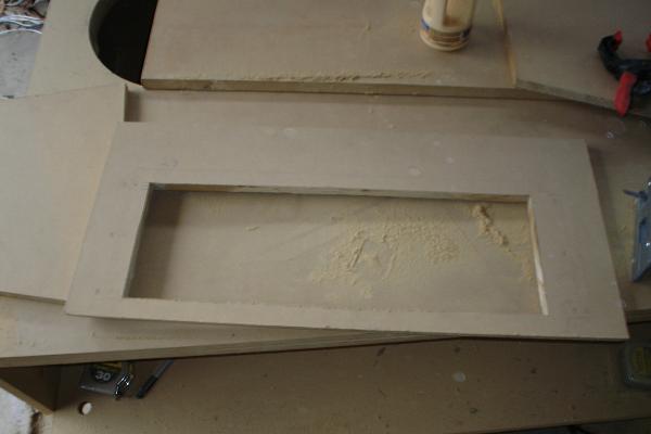

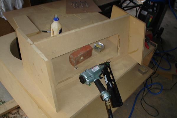

Gold Member Username: TejcurrentPost Number: 1775 Registered: Apr-07 | Basically finished the amp rack today. Should get more done this week. One sub should be in and running by wednesday hopefully. The piece I worked on today is really more like just a place for more batts and fuses. Pics of today: Those dark boards were just in there for spacing while assembling everything, but they might stay since they'd be hidden anyway. Bracing- 5/8 threaded rod. I couldn't see a reason to go bigger when this is just so solid. ![]() |
