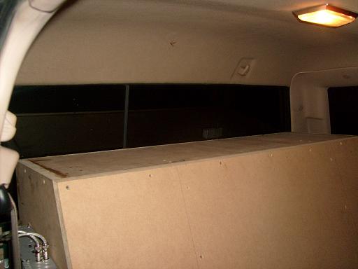

Finally began the build for the new box on paper it will be 6cuft after displacements with 2 6in aeroports tuned to 33hz more to come tomorrow......

how thick is the wood at the bottom? looks thicker than 3/4
Username: Surferdude9371
Get loud or go home....
Post Number: 1695
its all 1 in mdf

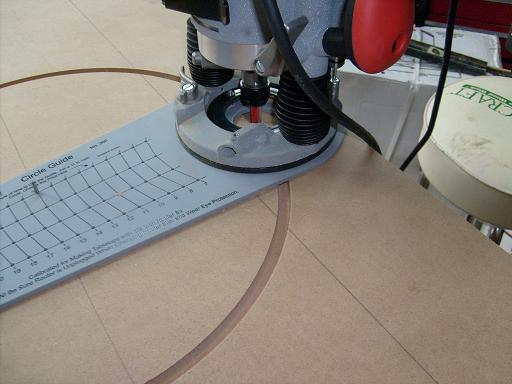

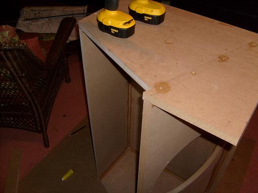

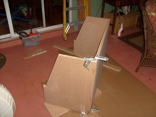

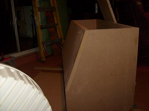

well end of day two i have a pinched nerve or bad disc in my back so its too painful to work i have a fun doc appt tomorrow but got the last 3 cuts made today and laid one of them on there to give you an idea of where its at. Tomorrow i will do the cut out for the sub and mount two of the last three pieces, and if time allows begin bracing.

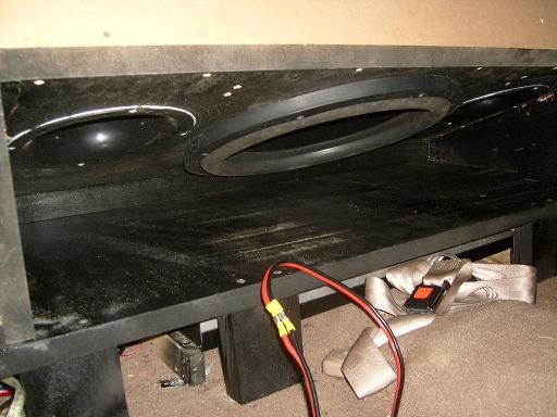

im building a platform for it to downfire on thats what u see in the first few pics

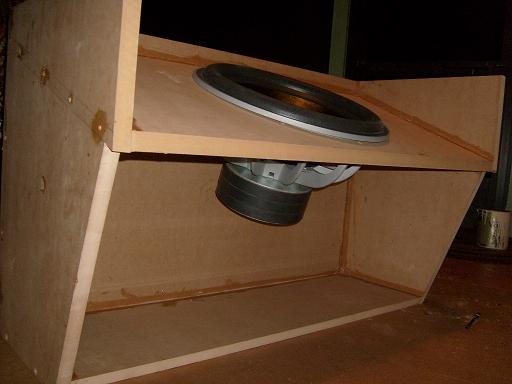

this is a preview of how the sub will be mounted its angled of course this is not to scale lol

well heres end day 3 got the sub hole cut out and the top and bottom mounted caulked the box (tube broke thats y its such a mess) and checked the mount thank god its gonna fit.

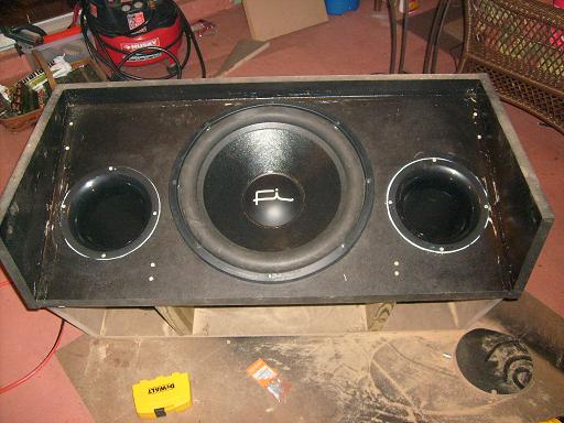

heres the finished platform i also painted the bottom of the box forgot to take a pic...... the amp placement is not final it will be moved.

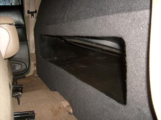

FINALLY DONE!!!!! got it in my truck bigger box and lower tuning it slams the lows. Sq is vastly improved i did notice a 2 db loss testing to the same songs i used b4 but all of the spl is blocked by the seats....... so who knows the sq improvement makes it all worth it. Trim plates soon to come....

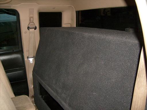

Post Number: 1770
and the trim plates......
It looks a lot better but also sounds better the back window doesnt bang anymore, no more rattles, and all of the sound comes forward now worth every penny

Username: Snowball123
West Allis, WI
Post Number: 2538
how far are those aero's off the back wall? looks pretty close. looks nice with that trim panel though. good job.
Post Number: 1771
its the angle there is a 2-3 in gap
West Allis, WI
Post Number: 2539
and those are 6" aero's? I thought the rule was to have 6" or however big the dimaeter of the aero was, off the back wall.
Post Number: 1772
idk that may be true but sounds fine
West Allis, WI
Post Number: 2540
only thing it would affect would be the tuning.
Post Number: 1773
lost about 3dbs or so but i also lowered the tuning a lot and thats with all of the sound pressure being blocked by bench seating. i built this as more as and sql setup rather than higher numbers sounding like crap like my last box
