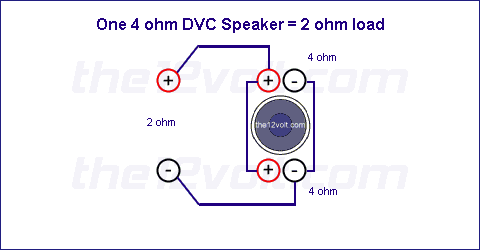

Silver Member Username: Vivi2000Owosso, Mi Post Number: 124 Registered: Aug-07 | If you are trying to achieve a 1 ohm load you can do it 2 diffrent ways. First is the way in the link from my last post, use only 1 pair of outputs for that. The other way is to wire each to 2 ohms, then put each subwoofer on a pair of outputs. the amp will internally bridge to 1 ohm if you do that, so you end up with the same result. It is just for whatever is most convenient for you. |
New member Username: Jdogg2121Post Number: 4 Registered: Feb-09 | so if i wire both like this then put each sub in a set of outputs then the amp will bridge internally to 1 ohm. thanks ![]() |
