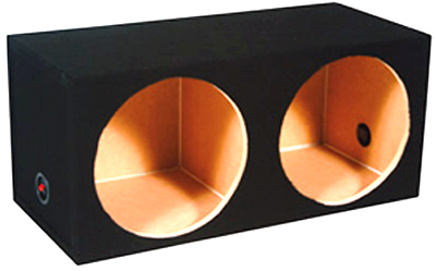

Bronze Member Username: Nickadam55Post Number: 33 Registered: Feb-09 | Okay well over the weekend i went on a little ebay spree and for the hell of it bought a bunch of stuff for my work car(their not gonna be happy but oh well)! this is what i have HU- Alpine 9886 Amp- Rockford fosgate t500-1BD Speakers- 2 Rockford fosgate P310D2 box- bass reflex wires- 4 gauge with 500K cap i think How should i hook it all up do i need crossovers? equalizers? anything like that? suggestions please. thanks guys. |
Gold Member Username: Drant19DUB-C, TX Post Number: 1439 Registered: Aug-07 | nice HU and amp. questions: is that box a prefab box? if you bought it on ebay then yes. maybe you should cancel the box and maybe the subs... P3s are decent but maybe could have done better for the money. overall it seems ok |
Gold Member Username: Nd4spd18Philadelphia, PA Post Number: 9978 Registered: Jul-06 | Prefab ported box is gonna sound like crap, they are tuned WAY too high. Cap is not needed At the very least you got a great HU though. |
Bronze Member Username: Nickadam55Post Number: 40 Registered: Feb-09 | okay the amp has changed to a P1000bd and box is now this one now what do you think? |
Gold Member Username: Nd4spd18Philadelphia, PA Post Number: 9987 Registered: Jul-06 | A prefab sealed box is ok if it is the correct size and made of 3/4" MDF nothing less. For best results the box needs to be built for the sub though. www.fishercustoms.com |
Silver Member Username: ExigeCDT, Audiopulse Dealer Post Number: 758 Registered: Nov-07 | How much airspace for each sub does that box offer? Your subs need .65 cu ft each...say .75 after driver displacement. |
