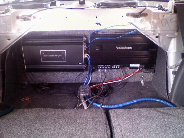

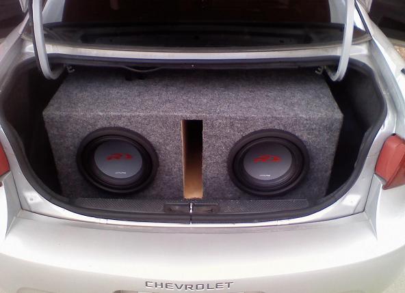

well, its done and in...had to cut and bend a brace for my rear package tray to get it to fit, but it was worth it :-)
It hits hard enough to hurt and make my body itch. My neighbor told me that after the initial tuning the colors on his projection tv were misaligned, and I've been banned from tuning at my house due to my roommate complaining, lol. I'm slowly tweaking the crossover freq's cause it's muddy with bass guitar chords, but it sounds amazing with any type of bass music.
I want to see what it hits on a meter now...
Here's the box:
The trunk arms literally slide along the carpeting, lol
Ignore the wiring mess, it'll be cleaned up later this week...you can see on the right side where I had to cut and bend the bracket.
