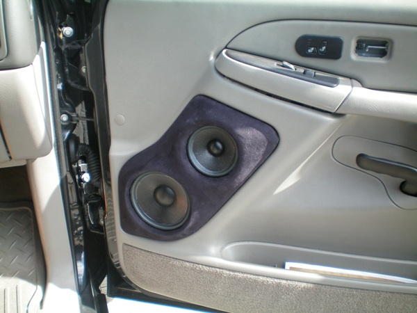

What's up guys?? As some of you guys know I fiberglass my front doors to fit a 6 1/2 and a 5.25
I also bought a second set of mmats pro 651 for my rear doors. After making the rings i realize they are not going to fit.I am about to fit two 5.25. My option is buy a 5.25 mid woofer for 70 bucks(140 a pair)? Second option is install 6 ½ on and the tweeter on the rear door. Fiberglass the front pillars for the 5.25. Which do you guys think I should do? Below is a pix of option 2.

Nice fabrication there and nice equipment.
As for the rears you don't need them..... but if you insist, using the exact same speakers is the correct way to do it.

If you do insist on rear fills i'd go for option 1 as M.S suggested.
Option 2 would require active filtering on the 5.25 mid for a very narrow bandwidth (perhaps 1khz to 5khz). However, very precise tuning will be required to achieve seamless blending between these mids and the other HF drivers.

gorgeous glass work.
go with 5.25" in the rear doors, no tweeters, and use a bandpass filter on them, with a Q factor of about 18dB @ 500-5KHz, and wire the rears in series, on a bridged pair of amp channels (mono wiring) to avoid destroying your front stage imaging.

Thanks everyone. I will take Glass advice.
