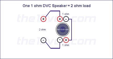

New member Username: MikiedooPost Number: 1 Registered: Jan-09 | Hi guys I have a 15" BTL dvc one ohm sub. Right now i have two Hifonics BXi 1608D powering this sub. I have each amp hooked up to each voice coil. I have gain matched the amps and the subwoofer pounds. I want to upgrade but not sure what to go with, but i am not sure how to wire the dvc one ohm sub down or what it will ohm load it will come out to be. If you guys could help explain how to wire this and what amp would power this sub the best, i would really appreciate it. Under $900 on the budget and i only want to go with one amp. Thanks guys, Michael |
Gold Member Username: Big_edge_headMilwaukee, WI Post Number: 3221 Registered: Mar-07 | Probably should of went with the D2 ohm. http://www.sonicelectronix.com/item_16163_JBL+GTO24001.html# Wire like this: ![]() |
