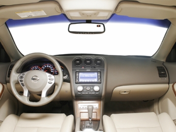

ok so i'm gonna get a 2009 Nissan Altima Coupe. It has a GPS touch screen double din headunit. I am not gonna change this out, cause it has voice activation and a bunch of other cool features..
I plan on getting a
15inch Audiopulse Axis
AQ 2500d
What will i need to hook this up to the factory headunit.. Is it possible

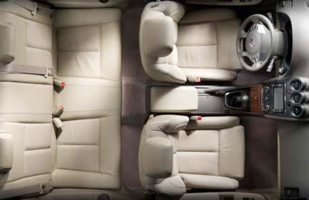

I do not plan on upgrading speakers, it has 9 speakers and 2 subwoofers i think, It is a Bose system so no point in replacing them i just want some thump.. The trunk is 7.8 cuft so im tryin to figure out how im gonna do this, but thats for another thread..
Thanks for the help here are pics
