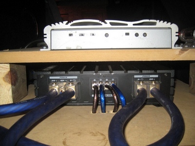

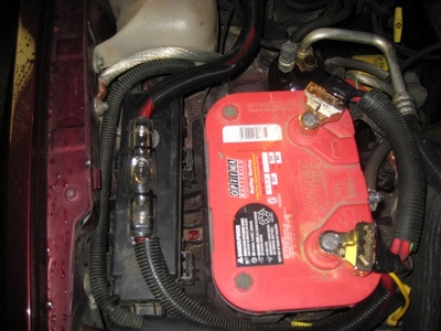

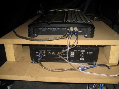

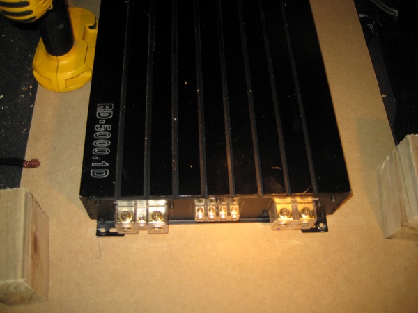

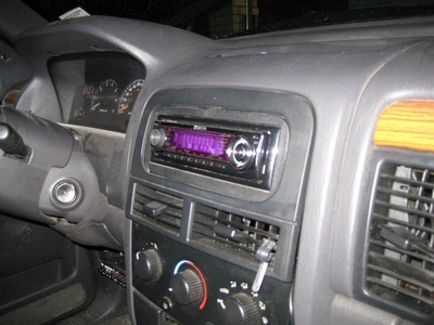

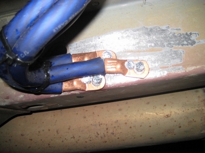

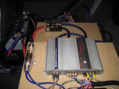

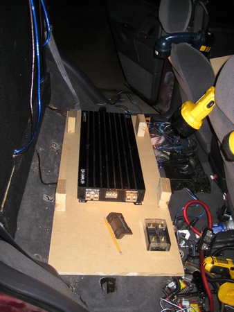

Got the RD5750.1 in today.. It is built like a tank.. I was confused at first.. It has the old Rd5000.1 heatsink but the PCB was replaced with the 2008 RD5750.1 PCB.. I went ahead and pulled out my backseats and threw together a lil' temporary amprack untill I wall it out with a 3rd 18.. My 260 amp. Mechman Alt was shipped to me on Wed. and should arrive on Monday(hopefully).. I am really enjoying the H.U. I bought from Sean... U.S.B. FTMFW! Got a 8gb. memory stick and still have plenty of room on it. The amprack is not complete but it will get me by for now. I will soon be trashing the Redtop. and replacing it with my SVR under the hood. Steve Miller is finding me a couple of batteries (70#'ers) to go in the back.. I ran my grounds straight to the frame rail under the Jeep.. Will see how this works out.. Also grounded battery to the same frame rail.. Added a lil 2 channel Alpine amp (30 wrms x2) to run 2 more Pioneer 22mm silk dome tweets and give a lil boost to my Cadence Clv Comp set.. I will soon be adding custom fiberglass Kickpods with a set of 6.5"Diamond Hex's. Will need to find a good amp to push about 180-200 wrms/ channel to drive them.. At that time the lil Alpine amp and pioneer tweets will be history. But evert lil bit in the fronstage helps.
Got the Bass boost all the way down and the gain it maybe 1/16-1/8 of the way up as a starting point. Not gonna do much fine tuning until I get the Alt. installed. And even then I'll have to worry about smokin' the subs. a 5750.1 is a lil overkill for 2 18" Alpha's v.2 @ .5 ohms. With these settings on the same charging, It already (easily) hits harder than the 2 bxi2005's did. But couldn't really jam for too long due to voltage drop. Still have a long way to go.. Thanks for taking the time to read this...

I feel bad for that everstart and red top. That amp will need you to replace them batteries with a AGM under the hood and 2-3 group 31 AGM's in the back.
When you get the individual ANL holders it will also help. Really just be carefull until you get the electrical needed. The amp runs risk of failure, running hot, running with higher T.H.D. with impropper electrical.

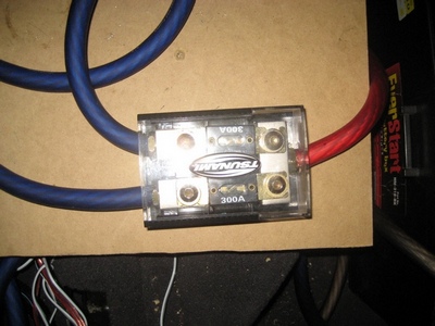

Steve, Is there something wrong with the ANL fused distribution block that I have on the amp? It should have the same function as the Tsumani's that I have coming.. At least I thought it did. It has 0/1 awg. input with separate 0/1 awg outputs each with a 300 amp fuse on each output.. Or are you saying that a 0/1 awg that I have going into the fused distro block would get significantly better current if each fused input was ran directly from the battery and not split?

You would get less resistance with a 2 seperate runs of 1/0 instead of that split single run. Don't know that it would make an enormous difference but it should make some.
I'm to the point now where I NEVER let anything drop below 12.5v, I figure if its that big a strain I should buy more alts or batts or something lol. Last time I let it drop to 10.5 I had to send an amp in for refurb :-( Never did that again.

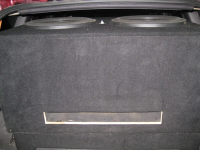

that box your currently running does not have enough port area :-(

I let all of Steve Miller's peep's do the testing, lol... I built the box that Steve designed with the exception of Double-baffling top and bottom and all-thread. It is a very musical box that hits the lows great and the Highs are astounding.. This will all change when I add the 3rd yadda yadda yadda, lol I am sure y'all are tired of hearing about that.lol

Hard to tell but that looks like a frame ground?
I like. Too many people ground to the body and then wonder where their electrical bottleneck is. Hmmm, mabybe that little strap grounding the body, lol.

yes it is better to run seperate 0g wires to get the current to the amp but if you drop 10.8 now it will drop even more with 2 wires.
I think with the alt and couple more batteries you will stay above 12v
