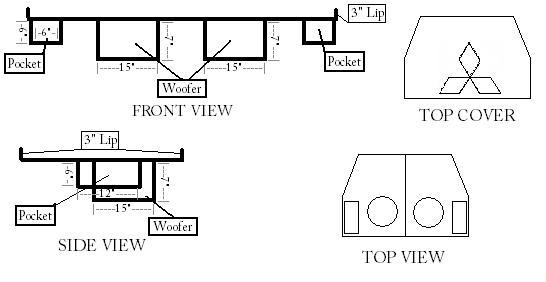

Username: Tycoonbob
Ky USA
Post Number: 243
Ok, so I been tinkering with a new idea...and its a totally redesigned box. I feel like an indecisive girl. =/
Opinions on this?
It will cover the entire trunk, but will initially still give me a trunk, just not as deep as it used to be. I will have the top cover lay over the top, and have the Mitsubishi logo cut out of it and have a mesh grill behind that. There will be little pocket compartments on each side, basically for fun. The box will still be sealed...but the top part of each sub box compartment will be the big top panel piece that covers the entire trunk. Amp would mount on the REAL trunk floor, and is accessed by lowering the back seats.
If any more clarification is needed, LMK.
