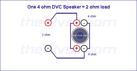

Platinum Member Username: InsearchofbassPost Number: 10888 Registered: Jun-04 | Why not wire it to 2 ohm? |
Platinum Member Username: InsearchofbassPost Number: 10889 Registered: Jun-04 | ![]() |
Gold Member Username: Surferdude9371Get loud or go home.... Post Number: 1446 Registered: Mar-07 | i doubt the sub is stable at that but idk for sure |
