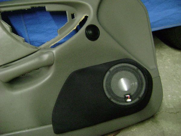

You need to use your imagination. I bought a set of Q-form kick pods from crotchfield. They were open backed and would seal up against the carpet, that wouldn't do. I prepaired the inside added wooden baffles glass the inside and backs to the shape of the floor to form an enclosure. They sound awesome and handle a lot of power (200rms each, 800w total) and are extremely loud lOl. This pic is during fitment...Polo.

thats gonna be pretty expensive if you have a shop do it..
just seal off your doors.. mine are completely solid like a 1 cu. ft. enclosure which my mids love
anyone who hears my car cannot believe the SQ of it.. the tweeter placement when tweeked on the HU is phenominal.. i dont even have subs in right now.. the midbass is plenty although i would like a more pronounced low end

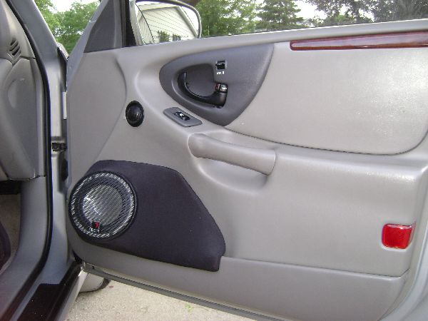

Username: Rovin
1 15 = 149.5 DBsTrinidad & T...
Post Number: 14329
im gonna get flamed for IMHO comments & im not a sq expert but here goes :
1st set of pixs with square box - could have been done neater or more rounded , that square just looks so odd
2nd pix - tweeter is too low for proper imaging & overall depth , black clashes with original door color
3rd pix - same as above but this time tweeter is near the floor which is worst
4th pic - is that a tweeter near that handle on ur ceiling ...wtf ...1st time im seeing something like that
tweeters r usually placed behind side mirrors (for a stock\stealth look) or on dash or more accurately on the 'A' pillars ...

i don't know about the other guys but i know for a fact that polo's tweeter position works. i have heard a car with tweeters down there. it works cause its facing up. sounds really good too.
as for the other guys, i am not sure how it would sound since its firing right at your leg.
as for mine, i have mine placed at the top of the door panel facing towards my rearview mirror. i got the best imaging like that.
the trend in speaker placement these days for sq setups are on the dash. the tweeter and the mid on the dash and the woofer on the door. that is if you have a 3 way.
for the topic of this thread, yes it will sound alot cleaner if the speakers were in an enclosure. the mid bass will come alive.

"4th pic - is that a tweeter near that handle on ur ceiling ...wtf ...1st time im seeing something like that
tweeters r usually placed behind side mirrors (for a stock\stealth look) or on dash or more accurately on the 'A' pillars ..."
i tried A-pillars.. this position sounded way better, i tested every position in my car which is truely how to find the best SQ FYI
if you can't hear it don't comment it

mike, yours is definately unique. doesn't the tweeter on the left side over-power the one on the right since its right by your ear? definately a good surround sound type of install though. i want to try that now. but with extra tweeters that are soft.

"mike, yours is definately unique. doesn't the tweeter on the left side over-power the one on the right since its right by your ear? definately a good surround sound type of install though. i want to try that now. but with extra tweeters that are soft."
I put the tweeter level on 1 out of 3.. and put the EQ down a bit on the tweeter frequencies.. sounds like your in the recording studio, you hear EVERY detail in the song.. nothing is overbearing or harsh, and the tweeters face the opposite sides ears so it hits them perfectly
seriously try this out its unbelievable.. my friends can't believe how good it sounds
i also love how it sounds amazing at ALL volumes, it fills the cabin with sound your not just hearing it from your feet its awesome
The tweeter is not too low. I've had it up in the apillars and it just does not sound right at all. It's perfect where they are right now. I can aim them where I want with the swivel cups. And I like the black, it goes well with the other things inside the car so fuck you, Rovin.
