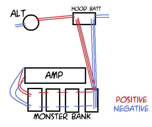

Guys. You have to run multiple runs of 0/1 if you want good voltage.
I have 3 positive and 3 negative runs from my front battery to my back bank.
200amp alt and 6 kinetiks.
I try to get it to drop and cant.

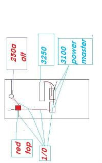

@Andrizzle "multiple runs" i'm about to do another run 1/0 of + should i do a run of - too? i just got it grounded in the back no runs??
Username: Andrew571
Post Number: 2037
forget grounding to chassis in the back.
This is how mine is set up. And it works really well.

@Andrizzle is ur setup Fused? i don't see any in ur pix.
Username: Andrew571
Post Number: 2039
Nope. No fuses. Screw rsistance! :]
IMO, as long as you know what you're doing, fusing isnt necessary
