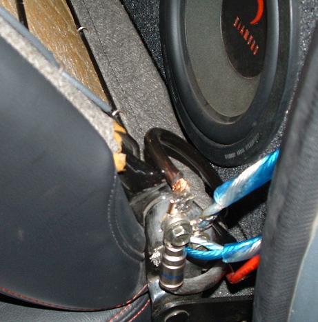

Only major snafu was nearly burning up the truck with a bad ground. I'd just finished everything and had the system cranked in a remote parking lot. I walked a good distance from the truck to hear it from outside, and walked back to see the whole cabin filled with smoke (uh oh).
It turned out that what I thought was a solid ground (bolt at the base of the rear seats), was only being grounded through the latch that allows the rear seatback to fold down. The vibrations caused the ground to go in and out many times per second, turning the latch (which wasn't terribly thick metal to begin with) red hot and smoldering everything around it. If the seats weren't made of leather, I'd probably be looking for a new truck..

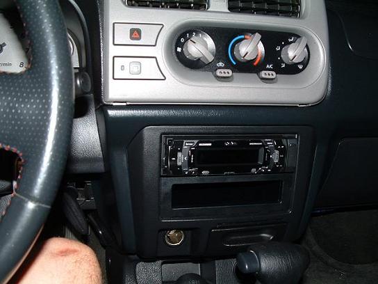

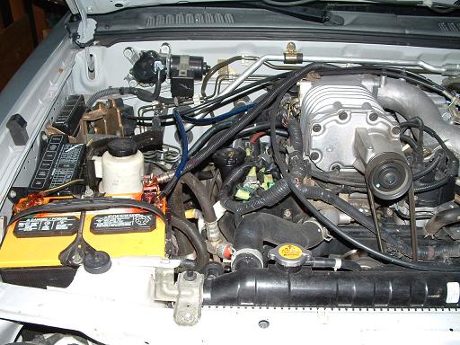

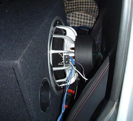

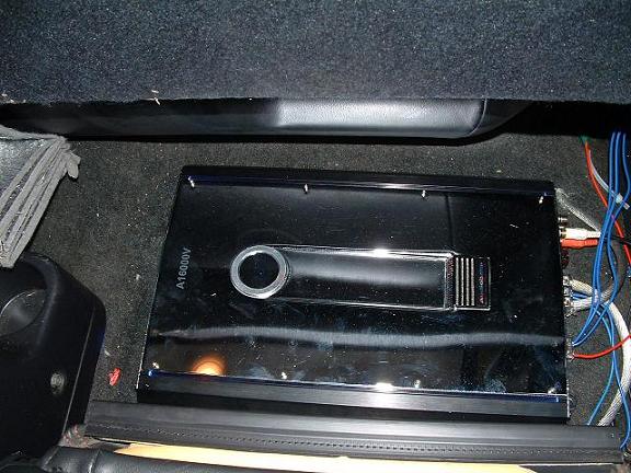

Please forgive the horrible image quality. Shots were taken in the pitch black, so flash made the pictures look worse than they normally would. Also there was some streaking in some of the images (most notably on the one showing the 8" enclosure) which makes it look like there's scratches which aren't really there.
Enjoy. Interior of this small truck is terribly cramped for room, so 12" sub had to sit on the rear seat, though it mounts nicely with no movement.

I did fix the ground by running two pairs of 10 gauge wire from the grounding location to another part of the chassis about a foot away. A temporary fix until I can get some 3 or 2 gauge wire from work and run a single ground.
