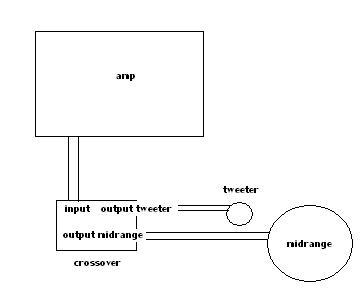

Silver Member Username: ComerzPost Number: 149 Registered: Nov-07 | yea thx berny that helps a lot. Other question. How does the wiring part work? im running my tweeters and front speakers to my crossover, and my crosover through my amp? |
Gold Member Username: BernymacCambodia Post Number: 4314 Registered: Sep-04 | ![]() |
