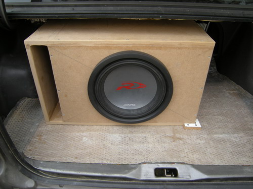

Silver Member Username: PaogrAthensGreece Post Number: 180 Registered: Dec-05 | A week ago i built a new box for my Alpine Typer 1222D. Previously i had a 2cf box at 32Hz with 33sq inches port area and i had done 139.9db at 39Hz. The new box is 2.2cf at 33Hz with 35sq inches port area. With this box i did 141.0db at 42Hz! Here are some pictures: and a video... http://s389.photobucket.com/albums/oo339/tsatasos/?action=view¤t=1.flv My amp is this one: http://ampguts.realmofexcursion.com/SinusLive_SL_A-1500/ The sub is wired at 1ohm. I'm very happy with the result. ![]() |
Gold Member Username: Talon01Team Revolution , Pa Usa Post Number: 1593 Registered: Jun-07 | not a bad score sir. here's a hint for you round your corners on the back wall and the port |

Gold Member Username: SouthernrebelMonroe, Louisiana 3 DD3515s, 2... Post Number: 6763 Registered: Mar-04 | Nice. Try 2.25cuft w/ a 35sq inch port ~16-18" long. |

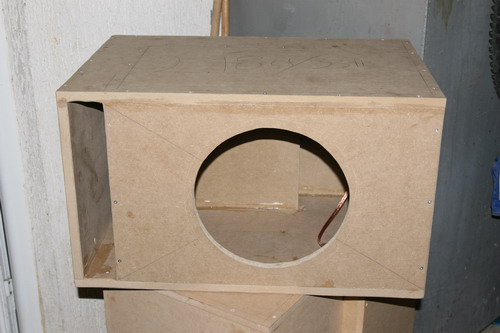

Silver Member Username: Evildoughboy08Toledo, OH US and A Post Number: 166 Registered: Jun-08 | what are your exterior dimensions and port dimensions for that box? im thinking of getting 2 type R 12s and i might just use this box setup |
Silver Member Username: PaogrAthensGreece Post Number: 183 Registered: Dec-05 | The previosly box was just a little better in the lows, but it was obviously worse in the higher freq. The box i have now i think is perfect for lows and high freqs. Here is the box plan: I forgot to tell you that i also did 137.3db @ 35Hz and 133.0db @ 30Hz with this box. I think these are good numbers (the subsonic filter is set to 28Hz) |
