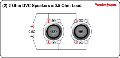

Depending on what ohm subs you have these are some of the wiring options you have. These first ones are for 2 dual 2 ohm subs
Wiring Option #1
Wiring Option #2
Wiring Option #3

Depending on the ohm your subs are and the lowest impeadence your amp can go wire your subs according to the diagram that best suits your setup.

wire each one separately and see if they work. if so, wire them up like the pics above to the right load.
