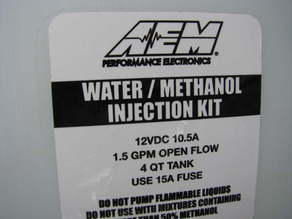

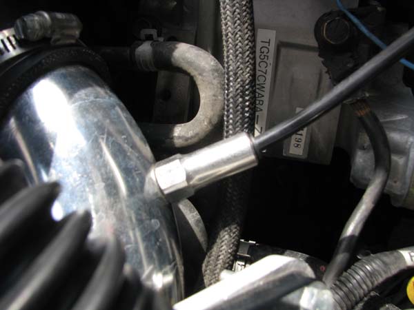

Gold Member Username: FrkkevinTeam DLSSuperNatural... Post Number: 5436 Registered: Nov-05 | .. left slack in the lines/wiring so it could be moved later when i finish up installing the rest of my audio equipment back not sure how i want it laid out yet big difference though ![]() |
Bronze Member Username: LoudnproudPost Number: 69 Registered: Jul-08 | so...this is one of those kits that makes your car run off of water, right? How much did it cost, and how hard was it to install? |
Gold Member Username: FrkkevinTeam DLSSuperNatural... Post Number: 5437 Registered: Nov-05 | no it don't make your car run off water.. right now its a 40/60% mix of alcohol/water the water helps cool the intake charge/motor where as the alcohol helps boost the octane my mix + 93oct should be close to 113oct its tuned to come in at 10psi.. this is like a good version of NOS but for a turboed/supercharged car.. runs cooler and produces a lot more power with the spray im running and mixture.. its good for about 40/50WHP |
Gold Member Username: JtownTexas Post Number: 3151 Registered: Mar-07 | so, purely for power? not mileage, right? |
Gold Member Username: FrkkevinTeam DLSSuperNatural... Post Number: 5438 Registered: Nov-05 | doesn't effect my fuel mileage since it itself is fuel basically boost octane/lowers intake and motor temp/allows higher boost |
Gold Member Username: JtownTexas Post Number: 3153 Registered: Mar-07 | and is this only a benefit for turbo and supercharged vehicles? |
Diamond Member Username: BestmankindPost Number: 22186 Registered: Oct-05 | nice kev. |
Gold Member Username: FrkkevinTeam DLSSuperNatural... Post Number: 5439 Registered: Nov-05 | its what you need chad and to buy my old turbo hehe |
Diamond Member Username: BestmankindPost Number: 22189 Registered: Oct-05 | lol no turbo til january. just wondering, is there a button you push? like nos? |
Gold Member Username: FrkkevinTeam DLSSuperNatural... Post Number: 5440 Registered: Nov-05 | nope, starts spraying at 10psi.. once i hit 10psi and it sprays.. it don't even take 1second for it to jump to 23psi |
Gold Member Username: Th3pwn3rI compensate... Post Number: 8652 Registered: Jul-06 | Make sure you've got a good tune. |
Gold Member Username: FrkkevinTeam DLSSuperNatural... Post Number: 5441 Registered: Nov-05 | already covered.. 20 passes and many datalogs later.. |

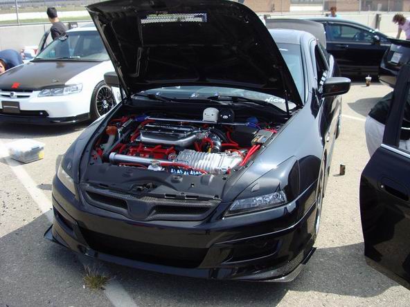

Gold Member Username: FrkkevinTeam DLSSuperNatural... Post Number: 5452 Registered: Nov-05 | SC motors are good for power down low but a turboed motor will always pull stronger up top i'd still do a turbo.. more efficient |
Diamond Member Username: BestmankindPost Number: 22212 Registered: Oct-05 | i don't know though kev. i know the turbo will give me better results but i have to get it custom for my car. lots of tuning on the dyno to get it right. but with the SC it basically bolts right on and give me instant power. lol. ok its not that easy but you know what i mean. comptech has superchargers made for my car and comes complete with a kit. so its alot less work. oh and i can still get a blow off valve for the supercharger. |
Diamond Member Username: BestmankindPost Number: 22213 Registered: Oct-05 | i can't wait. either the SC or turbo. lol. i mean just look at these pics. also kev, post some pics of your engine again. ![]() |

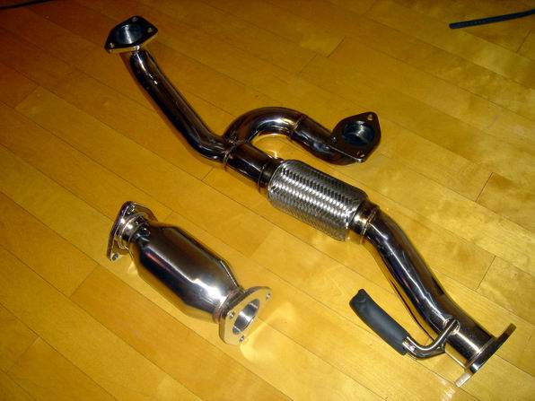

Diamond Member Username: BestmankindPost Number: 22216 Registered: Oct-05 | alright for the turbo looks like this is what i need. Rods- Paulter Pistons- CP Headgaskets- Cometic Headstuds- ARP (H23/F23 head studs work well for us, just need two sets) Other engine componets- Honda Oil Cooler- PermaCool Radiator- Absolute Thermostat/Switch- Mugen Plumbing- Earl's Performance/Aeromotive Turbo- Garrett GT35Rs Wastegate- Going to inspect the Tial unit we have. BOV- TBD Exhaust- Greddy Evo2 Piping- Type S Engineering Engine Management- AEM (Also investigating new Haltec unit) Axels- The Drive Shaft Shop |
Gold Member Username: Crayola0Portage, Wisconsin Post Number: 2489 Registered: Jun-06 | wow thats a lot of stuff |
Gold Member Username: Hittin1Lake Charles, La. United States Post Number: 1180 Registered: May-07 | big bucks... sounds nice though. |
Diamond Member Username: BestmankindPost Number: 22217 Registered: Oct-05 | well i already have the exhaust so that will save me $900. ![]() |

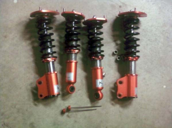

Gold Member Username: FrkkevinTeam DLSSuperNatural... Post Number: 5464 Registered: Nov-05 | chad this is for you.. ![]() |
Diamond Member Username: BestmankindPost Number: 22220 Registered: Oct-05 | nice. did you just get those? also how do you adjust the damper on those? is it easy to get to? like do you have to remove the wheels to do it? |
Gold Member Username: FrkkevinTeam DLSSuperNatural... Post Number: 5465 Registered: Nov-05 | No clue.. paid for them yes.. guy is trading in his LGT.. hes local but still a good 1-2hr drive so I've yet to pick them up I saw him last weekend at the big subie part while my meth was getting tuned my car might be too low on max height settings ![]() |
Diamond Member Username: BestmankindPost Number: 22221 Registered: Oct-05 | "my car might be too low on max height settings :-(" slam that bish. slammed ftw!!!! btw your car is awd right? |
Gold Member Username: FrkkevinTeam DLSSuperNatural... Post Number: 5466 Registered: Nov-05 | yes, every subie made is awd unless altered for me to slam my car i'd have to get some wheels with less offset or tow it in nasty i might rub with it set on max.. k-sports can really drop a car |
Diamond Member Username: BestmankindPost Number: 22222 Registered: Oct-05 | yeah k sport dumps your car like nothing man. that is why i want those. i am so jealous now. run some neg camber. i know the tires will wear faster and uneven but around corners it will handle better. |
Gold Member Username: FrkkevinTeam DLSSuperNatural... Post Number: 5467 Registered: Nov-05 | heres a stocker with some ks.. not sure how far he has it adjusted http://a941.ac-images.myspacecdn.com/images01/52/l_9161f3db9a327ea79e82825148717 7b4.jpg |
Diamond Member Username: BestmankindPost Number: 22223 Registered: Oct-05 | i'd slam it more. lol. it looks good though. |
Gold Member Username: FrkkevinTeam DLSSuperNatural... Post Number: 5468 Registered: Nov-05 | roads are too rough in texas ![]() |

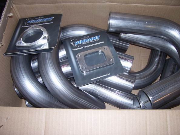

Gold Member Username: FrkkevinTeam DLSSuperNatural... Post Number: 5487 Registered: Nov-05 | meh.. that turbo vid is lame your not going to get the sound until it create boost and well thats not until there is a load on the motor.. not in N besides you get the nice spool/flutter from a turbo :P |
Diamond Member Username: BestmankindPost Number: 22233 Registered: Oct-05 | that is sick man. damn. |

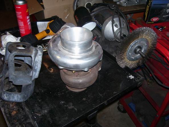

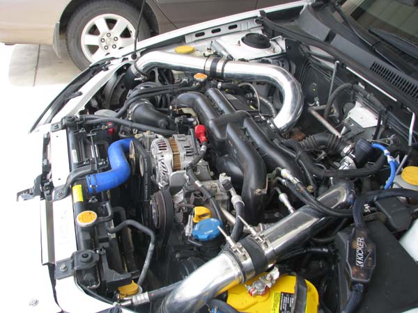

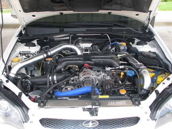

Diamond Member Username: BestmankindPost Number: 22234 Registered: Oct-05 | ok this is the turbo that the guy is doing the group buy for. it sounds nice. http://s154.photobucket.com/albums/s262/joe80055/Chief%20Turbo%20Install%203/?ac tion=view¤t=Picture001-1.flv |
Gold Member Username: JtownTexas Post Number: 3193 Registered: Mar-07 | turbo chad!!! |
Gold Member Username: FrkkevinTeam DLSSuperNatural... Post Number: 5488 Registered: Nov-05 | i should record my car for you chadly :P |
Diamond Member Username: BestmankindPost Number: 22236 Registered: Oct-05 | do it. man but that sc whine is just too sick. really sounds like a formula one car driving down the street. post a vid of your car driving by. |
